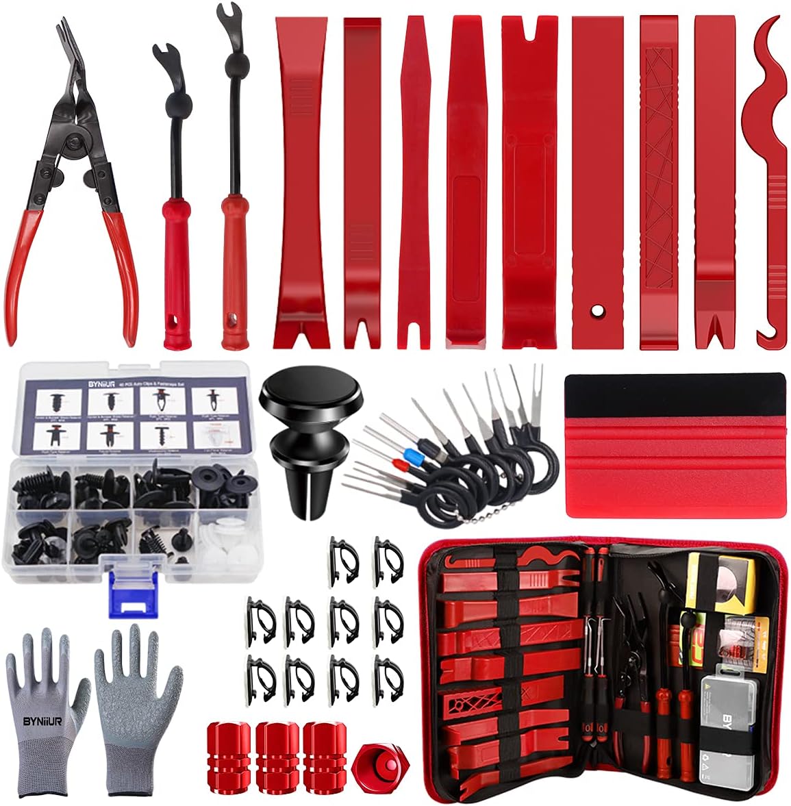

    A while back I picked up a nice kit for removing push rivets and all manner of auto trim and other components. A very worthwhile investment (even includes an assortment of rivets) for $27:
