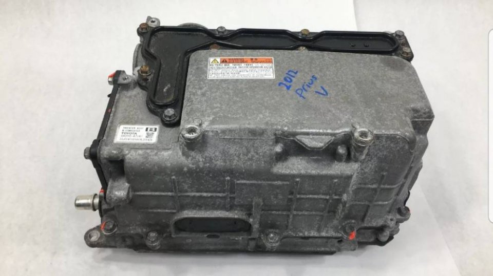

    By inverter you mean transaxle I’m sure??
    on the underside, at the seam between engine and transaxle, there’s a little recess. @Ragingfit tapped a cold chisel in there, loosened it up.

    Nobody else does. :) The inverter is the silver box that sits on top of the transaxle, and houses the electronics.
    The engine bolts directly to the transaxle. The "generator" (a/k/a MG1) and the "motor" (MG2) are in that order from passenger to driver's side, but they are both parts of the transaxle, and inside of it.
