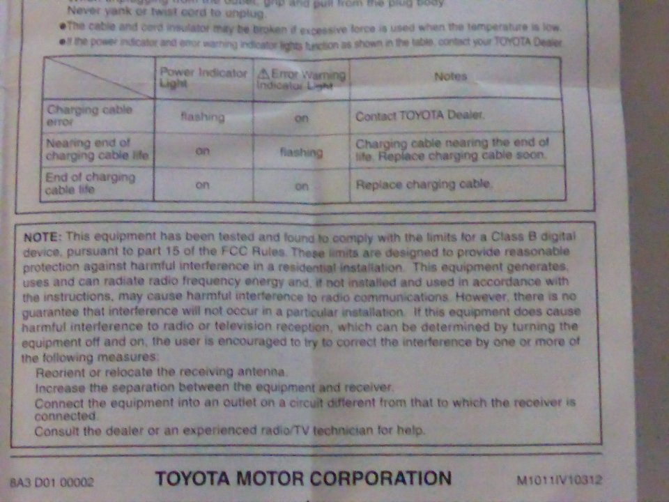

    It's right on the manual which comes with the charging cable. The light flashes to tell you the cable is coming to the end of it's service life.
    This topic has already been discussed another thread: Disposable charging cable? | PriusChat

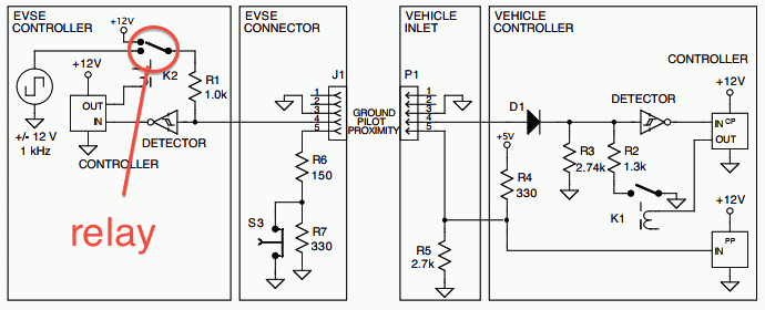

    Hmm... so these blue charging cables for our PiPs all use the SAE J1772 standard. According to SAE J1772 - Wikipedia, the free encyclopedia , this is the signaling circuit for the charging:
    The left side represents the cable, from wall power to the blue-handled connector. The right side represents the car's half of the circuit path. I suspect the likeliest "culprit" for the issue is that relay:
    I've been studying up on auto power electronics from car audio enthusiast sites. When performing tasks like installing secondary 12v batteries (for providing added power to feed their audio systems), a common improvement is to isolate the different batteries to reserve one for being able to start the car again after running the audio system while the vehicle is off. 2 common ways of battery isolation are using diode-based ones vs. relay-based ones.
    There're pros & cons to each and, for relays, it's that the relay will eventually wear out (because it's an electronic component that's actually switching back and forth, as opposed to the diode, which is solid state).
    As such, I suspect that it'd be this relay that's anticipated to wear out and need replacing before any of the other components, and it's most likely inside the controller box portion of the cable. Toyota's legal department likely wants to avert lawsuits from DIY-wannabes crispy-frying themselves on a 12A current path to try to save themselves a few bucks. Toyota also likely doesn't wanna deal with the added complexity costs of attempting to repair/replace small components inside larger, reliably self-contained components like "the entire cable" either.

    The more I look at the design of that circuit, that relay is really just part of a safety subsystem designed to break the connection if that detector sees anything amiss. You can see a similar, more sophisticated protection in the vehicle's side.
    Anyone with sufficiently competent electrician skill adventurous enough to disassemble the controller box an' document for us what they find? (I am obviously not condoning doing this if you are in any way less than fully capable.. :D) I don't recall off the top o' my head if that controller box enclosure was sealed with simple screw fasteners or if it appeared to have some more mystical and seamless method of enclosure..

    I wouldn't count on being able to jimmy the microprocessor that flashes the warning for a time before it disables the charging cable.
