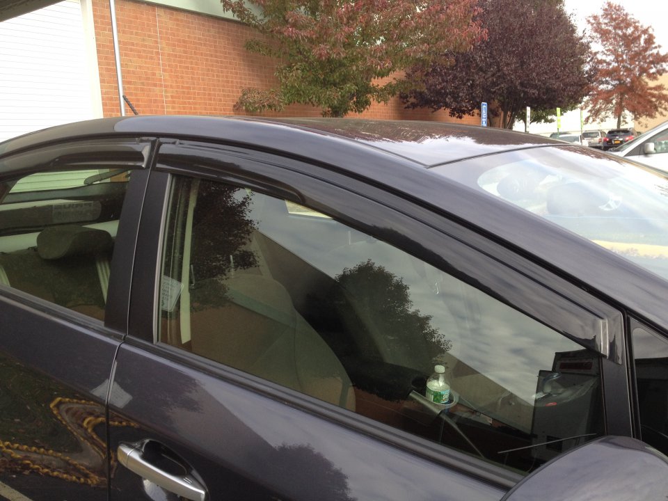

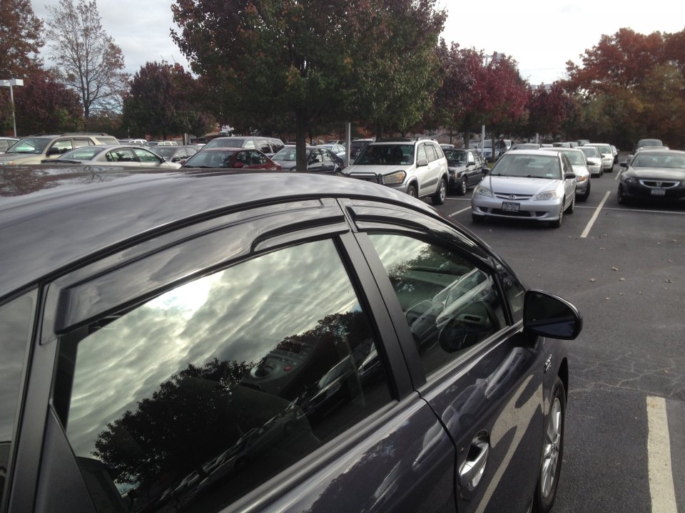

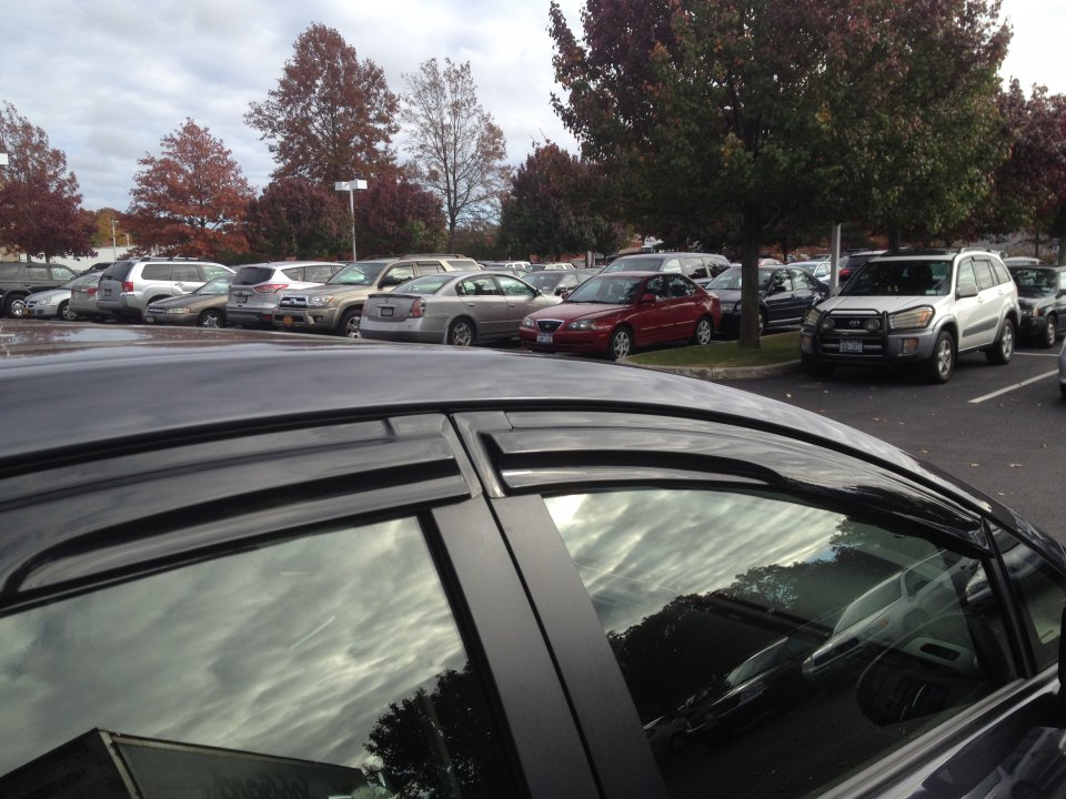

  6. mrbigh
    Sep 6, 2005
    3,686
    699
    Long Island, NY
    Here they are
  7. Sassylady
    Sassylady Junior Member
    Oct 17, 2013
    26
    Birmingham, Alabama
    Thank you for going to that much trouble. They look good to me. Did I miss it or did you indicate what brand they are? Again, thank you!
