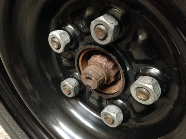

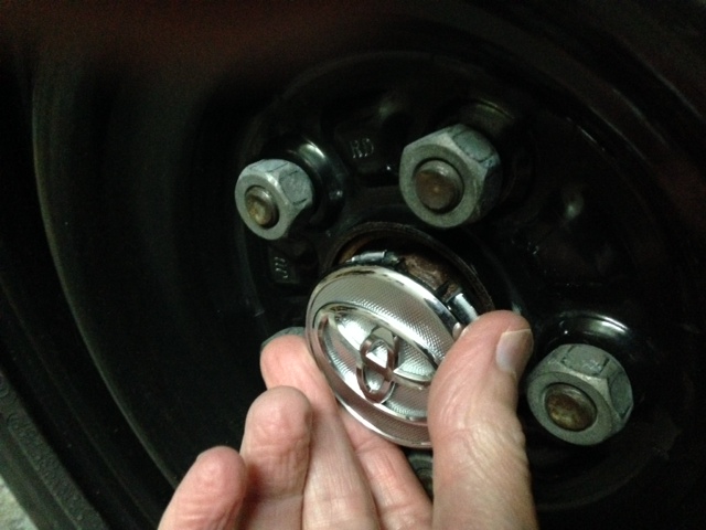

  19. Mendel Leisk
    Mendel Leisk Senior Member
    58,760
    40,461
    Just a couple of images to show the issue with centre caps on steel rims

    Yikes. That rust is scary. Now I'm contemplating running my stock alloys as winter rims and buying new larger alloys for summer.
