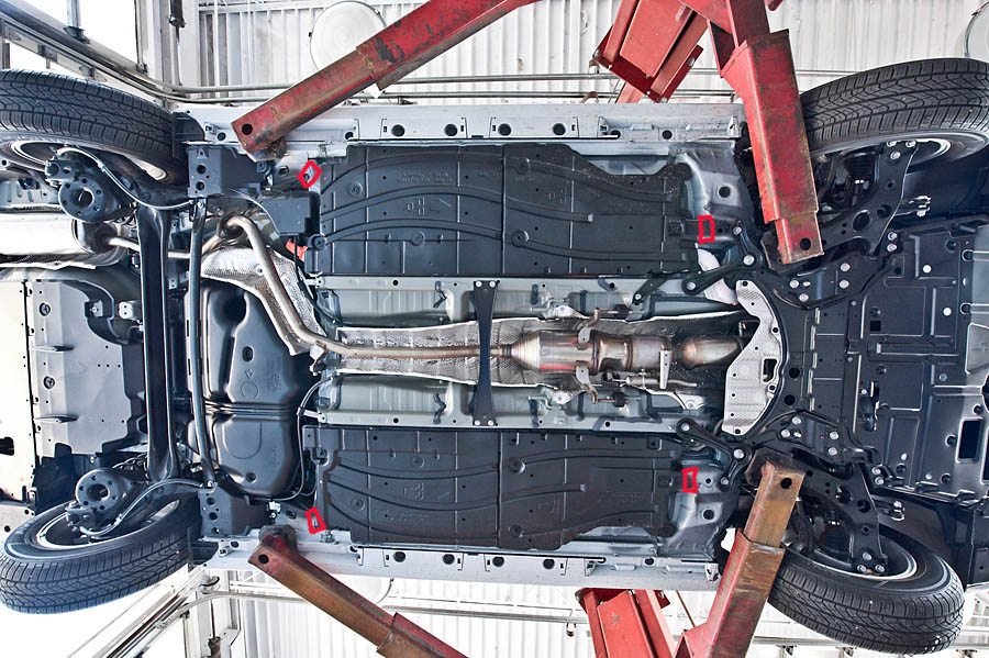

    Are you saying then, you run the front end up on ramps, and then when you bring the rear up and put it on jackstands, it's a little too high? If so, t can't be off by much. But if you deem it too much, want to get get it decently level:
    Go with NutzAboutBolts suggestion, use four jackstands. Now the issue is: thanks to Toyota's COMPLETE lack of reinforcement of the pinchweld at the designated jacking points, and the shape of the typical jackstand cradle (not remotely similar to the supplied scissor jack cradle), what to do.
    I've gotten away with setting the front jacking points on regular jackstands, once or twice. The car'll survive, but it won't be happy. The crimped edge may chew up a bit. What's worse is it does NOT inspire confidence; it feels like the car has a knife edge, balancing on a broad, flat cradle, and on an angle, threatening to kick out.
    If you just think happy thoughts, settle it down, then go round the back and jack up the rear and get the rear jackstands in, it'll survive. But I agree, it's not pretty. The simplest solution:
    Stick with the official rear points. They're lightly loaded, not so bad. But for the front, put your jackstands inboard, near the front end of the broad longitudinal rail. It's less than a foot away from the kosher bearing point. And it's wide, heavy guage, and doesn't mind the bearing being on a bit of angle on the outset. It's the red-marked points in this pic:
    And here's a plagiarized pic (from Hobbit?). It's second gen, but very similar, showing the jackstand in position, a bit upsampled:
    Also, if you don't have tire chocks, it'd be good to pick some up with the extra jack stands. Use them on whatever wheels are last on the ground, and ditto in reverse when lowering the car.
    Something I like to do also, is put a section of tree stump under before I get under, for insurance.

  8. Mendel Leisk
    61,426
    42,264

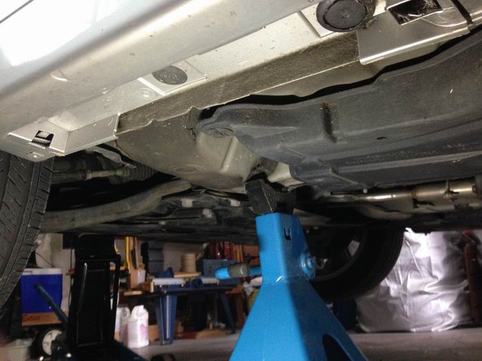

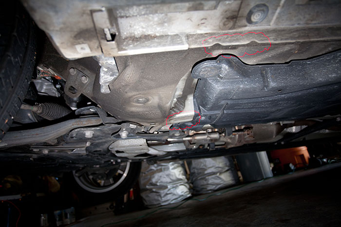

    Here's some clearer pictures (I hope) of my alternate front location for jackstands. First picture shows the pinch weld (driver's side) location and the alternate:
    And here's the jackstand cradle in that alternate position:
    Here's another of those complete underside pics, with my alternate REAR jackstand locations also marked:
    (With the rear though, the pinch points are a lot less stressed, there just not that much weight.)

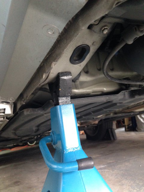

    Had the back end raised, so took a pic of where I'm placing the rear jackstand:
    (driver's side, looking towards front)
    (note wheel chocks, always a good idea, especially when raising the rear)
    xliderider likes this.
  19. xliderider
    xliderider Senior Member
    Apr 19, 2012
    8,140
    3,278
    Honolulu, HI
    Thanks for the pic. (y)
    No deformation of the panel, no creaking/groaning when weight is applied?
    I ended up buying a larger floor jack that would be able to raise the entire rear high enough using the rear jacking point. I must admit that the rear jacking point doesn't inspire a lot of confidence in me, it's just a piece of cupped steel welded to the frame? I also bought a second pinch weld adapter that I was going to try using with the jackstands in the rear, but I'll check out your location.
    I'm probably going to tackle the job this weekend. It will be close to 36k miles.
  20. Mendel Leisk
    61,426
    42,264
    Yeah, you can see the regular position in that pic, for orientation. Notice that slot-shaped plug. That plug is apparently installed at the dealership. The slot is reinforced, and that's an extra layer of heavy gauge plate. The dealership speculated it's for some sort of restraining pin during shipping, keep the car from shifting.
    The jackstand's turned 90 deg from usual orientation, to conform to the round of that plate. A pretty good fit.
    That center rear jacking point seems ok. I've used it quite a few times, no problems.
