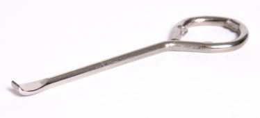

    A paint can opener is helpful for lifting the centre caps, with the right angle hook.
    Coupled with a slim flat blade screw driver. The main reason they jam, I think, is that grit gets into them. Washing them off with soapy water before reinstall helps. Just watch they don't go down the drain. ;)

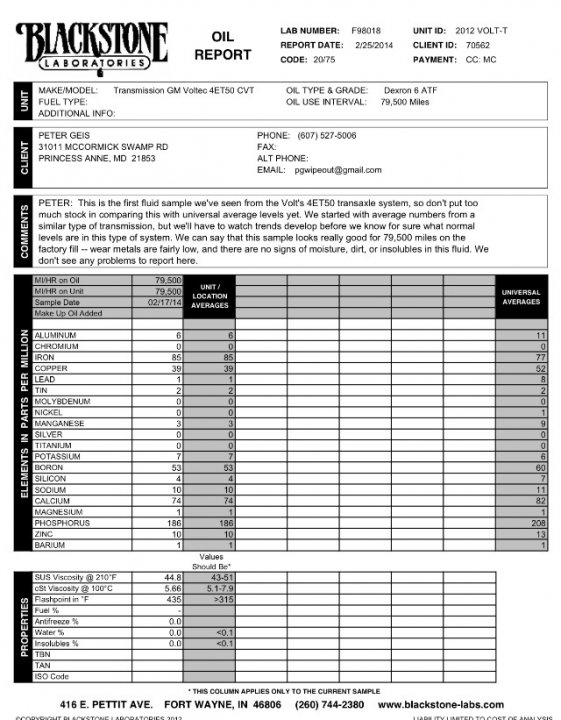

    Just for comparison, someone recently got a Blackstone analysis of their Chevy Volt transaxle fluid at 79,500 miles and got back results that look quite a bit better overall than the Prius transaxle fluid results that people have been posting here. And that's in spite of the fluid-bathed clutches in the Volt.
    Of course, that's only one datapoint. I may get my Volt fluid tested at some point between now (99,000 miles) and 150,000 miles whenever I get around to doing my 3rd engine oil change.
    79,500 Mile Transmission Fluid Analysis
    The 79,500 mile blackstone fluid report summary said:
    Has anyone seen Blackstone or similar transaxle fluid analysis reports for the newer Ford-manufactured hybrids?

    I can't upload the PDF here right now but here's an image snapshot of the PDF:

    Notice at the bottom TAN and TBN are blank? That's the most important result when chasing a Prius trans fluid UOA.
    How acidic is my fluid? That tells me the lifespan of the fluid in that trans at that mileage.
    They must charge extra for that.
    But overall that Volt report looks really really good on the wear. The Volt must be very easy on the trans fluid.
    Or someone is driving that car very nicely.
    But just cause it has low wear numbers it does not tell you how acidic its getting which if you had that number you could project how long the fluid would last in that trans. Its very important to modern transmissions and a UOA is useless imho without it.

    How can an oil analysis be "useless" when it's obvious the oil is full of crud, even though no TAN test was performed?
    Attached below is UOA of 3 different tests from 2 cars and a test of virgin Redline D6. The D6 shows TAN straight from the bottle.
    (These were from upstream in this thread.)
    Who believes there are bare uncoated copper windings in any EV motor? And acid build up, if there, will attack bare copper wires?
    Who believes WS is specially designed just for the Prius? It could easily be Toyota's generic ATF that they use across their fleet and it could be sourced from the same supplier that also makes Walmart's version of WS. What did the Gen 1 Prius call for in the transaxle?
    If you're going to crawl around under your car to show it some love, why not use the best lubricants available?
    Also, the ATF change can be performed through the engine oil change access door. Use an extension on the allen socket. You don't have to 'big deal it' and remove the whole belly fairing.
    The Volt transaxle has an electric circulating pump, a real filter, and a dedicated heat exchanger. (There are 5 heat exchangers in the nose). Maybe the filter is catching some of the bigger crud, and that's why the UOA looks good. It can go into 'Motor to Motor' braking when the battery is full from regen. The ATF has to absorb that braking heat.
