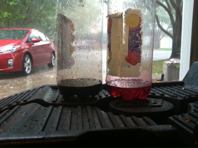

  6. Cooterk
    Cooterk Junior Member
    Nov 13, 2013
    As promised. Look at the difference.
      File size:
      119.6 KB
      Views:
      1,285
    Fostel and Mendel Leisk like this.
  7. JC91006
    JC91006 Senior Member
    Nov 10, 2013
    16,933
    8,643
    looks delicious.....like fruit punch in a drink container.

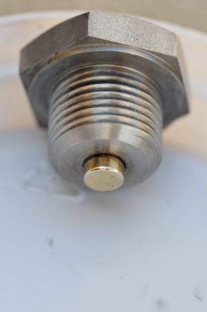

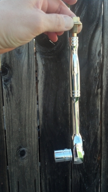

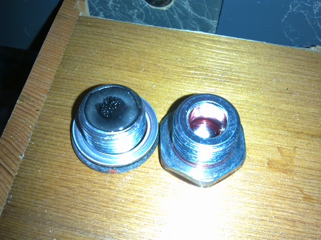

    Finally, the long delayed Gold Plug magnetic transaxle drain plug picture, on a young transaxle.
    NEW warranty transaxle replacement installed 2/2011 @ 99,114 miles. Hindsight, should have purchased the Goldplug at this time and have the dealer install it on this new transaxle.
    1st transaxle ATF drain & fill, w/ Gold Plug transaxle drain plug installed on 2/2013 @ 114,638 miles [Δ 15,524 miles]
    No original image from this 1st drain/fill. Borrowed an image from "speakup76" transaxle drain/fill; image appears to be the same, just a little bit more gray ferrous "paste," due to this being the 1st drain/fill. Minimal effort was required to wipe off the gray ferrous "paste." OEM transaxle drain plug could barley support the 10mm hex key socket.

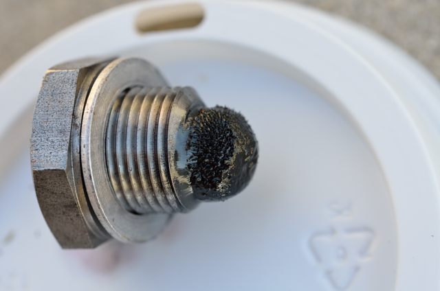

    2nd transaxle ATF drain & fill; 10/2014 @ 129,951 miles [Δ 15,313 miles]
    Lots of ferrous particles captured by the Goldplug transaxle drain plug. Considerable effort (time and rags) was required to wipe off the ferrous particles due to this strong magnet. Hindsight, I should have weighed the Goldplug before wiping and after wiping to get an approximate amount of iron removed for trivia's sake.

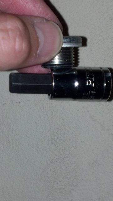

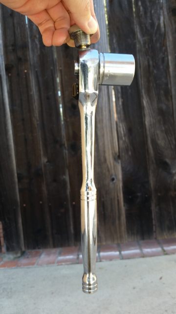

    Goldplug transaxle drain plug easily holding the tools used to remove this bolt ( 1/2 ratchet w/ 1 inch socket): 1lb 11.3oz (774 grams). It probably could have held more weight.

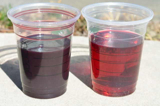

    ATF-WS comparison after 15,313 miles (drain & fill #2): Old (left) vs New (right).
    I saved some of the old fluid for analysis. Will report the findings later. Will be interesting to see if this will show a lot less wear than Professor Eddenberg's study over 3 drain/fills w/ oil analysis. Study Link.
