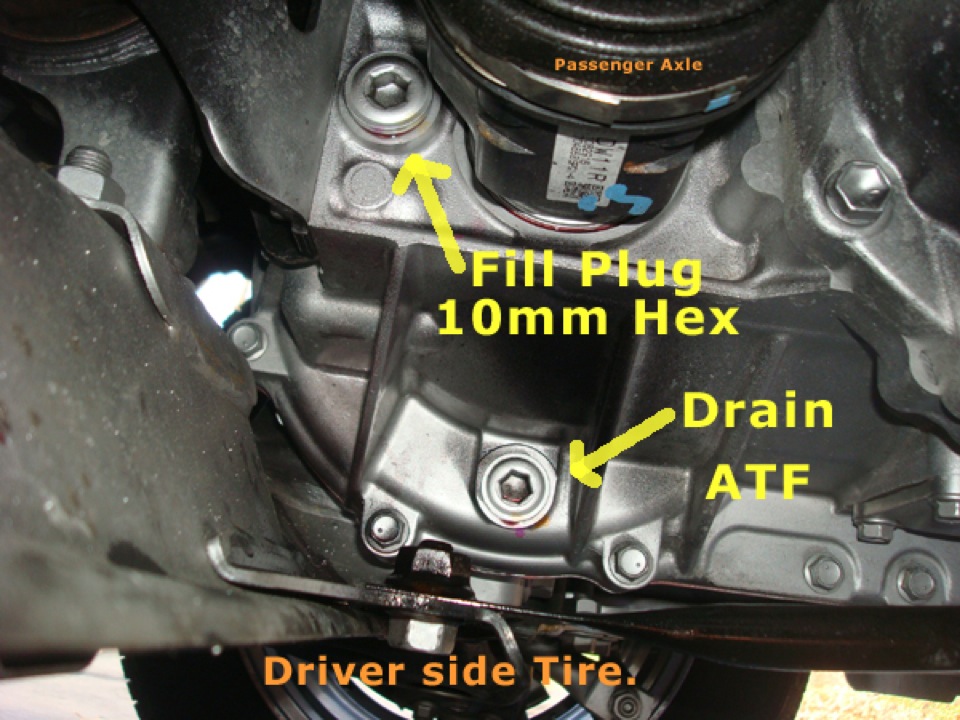

    Just finished my Prius 2011 - ATF change. I have 26,000 miles.
    Everyone was spot on with info here, even the thick opaque burgundy color of the ATF from the earlier pic I saw.
    I would like to emphasize two things.
    Drop the belly plastic tray with the oil door and have extra plastic pins for the tray. I broke a few, they dry rot or become brittle. The car is not garaged.
    One more note I forgot to do, per the instructions, is check the fluid level after you drive it a little.
    Great tip from here: Always remove fill plug first. (BTW, my two plugs do not contain magnets.)
    Also I am adding a pic because I dislike those black and white Toyota pdf files for instructions.
    It got messy because I used an electric 12v little pump and the hose slipped out and splashed everywhere, while filling.
    Fostel, Robert Holt, Dino33ca and 6 others like this.
  8. tankyuong
    tankyuong Senior Member
    Nov 9, 2012
    1,555
    662
    Central MO
    Way better pic
