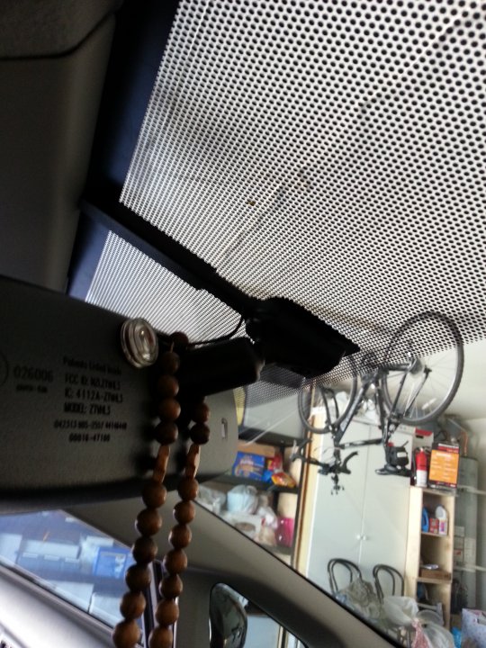

  15. Vitaliy
    Vitaliy Junior Member
    Jun 11, 2013
    47
    Thanks everybody. I did figured it out, installed and now enjoying auto headlights on my 2013 Prius 3. I didn't install light sensor on dashboard, but instead I put it on the back of rear view mirror. A little less disassemble, and much better looks. Sensor completely invisible from inside the car, and hard to see from outside.
    I ended up using both relays, one for parking lights, the other for headlights. It allowed me to use DRL as fog lights, independent from headlights.
    I also added 12 volts delay relay found on eBay for $15 to stop 545t from activation if I just want to briefly clean windshield. System works just as advertised, however its a little too sensitive.
    If anybody interested in details, feel free to ask.

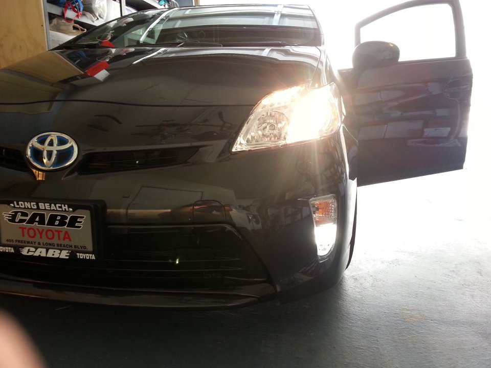

  18. Vitaliy
    Jun 11, 2013
    47
    Sure will do as soon as I get home after a little getaway with family. No later then Monday, promise. Hope everyone have a nice holiday weekend.
  19. Vitaliy
    Jun 11, 2013
    47
    I ended up buying this one DRL Timer Switch 12A 12V Time Relay 3 110 Sec Delay on Running Car Daylights | eBay. There are plenty of other options, but make sure you searche for 12V Delay ON relay.
    At first I did a mistake and bought 12v delay OFF relay, which works opposite from what we need (this one Directed 528T Dei 528T 12 Volt Pulse Timer with Adjustable Delay | eBay) It changes state immediately, but then there is a time delay before it's switching back.
    I also want to rewire DEI 545T, so I have time delay not only on wipers, but for light sensor as well. After using the whole setup for a week now, I noticed that 545T sensor so sensitive it would turn headlights on when I'm passing under a tree, or driving under freeway. Default 5 sec delay seems just not to be a long enough, I think 60-90 seconds delay would be just perfect.
    There is another idea I want to try..... the way sensor is working - it's shorted under bright day light, but then resistance increases as it gets darker. I'm thinking to play with different value resistors to slow down the process. Anyone with experience in electronics are more then welcome to chime in, any help on that would be greatly appreciated.
    As far as installation goes.. I mentioned before, that I didn't take a risk and/or wanted to have sensor on front of my eyes all the time to take half of dashboard apart. I mounted it on rear view mirror, as seen on pictures. To do it all you need is pull down the cover next to map lights , remove driver door rubber seal, then open side airbag cover, remove bottom plastic cover to expose fuse box, and last - remove lower steering wheel cover.
    I was wrong when I thought stalk connector on 2013 is different from 2010, i'ts exactly the same. So, I used pin 20 and pin 12 on L47 for headlights, and same pin 20 and pin 13 for parking lights. If you don't care to have DRLs on at the same time as headlights/parking lights you can you use only one relay, just as it explained in OP. But keep in mind, if you going OP road, and using only one relay and your stalk in DRL position 545T WILL NOT TURN PARKING LIGHTS ON, ONLY HEADLIGHTS WILL BE TURNED ON. If you using both relay as I did, you shouldn't worry about stalk position, you will get both headlights/parking lights on stalk OFF, or stalk DRL.
