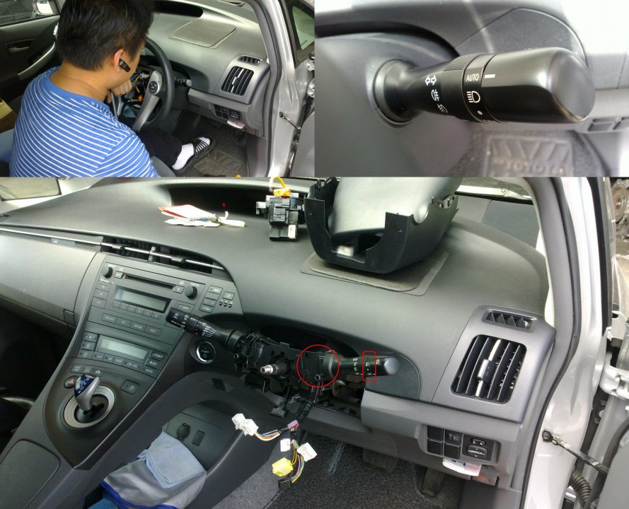

    Wow, it sounds so complicated. I only sent mine to get the headlight turning knob modified by cutting the inner step stopper plastic to allow the extra switch. The ring with "AUTO" imprint was also replaced.
    No extra wiring or rewiring as there's already a light sensor next to the front speaker behind the MID.
    The headlights automatically turn on when UV light (I'm guessing) is low, automatically turn off the light after the driver's door is opened when the system is off.

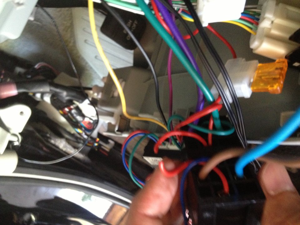

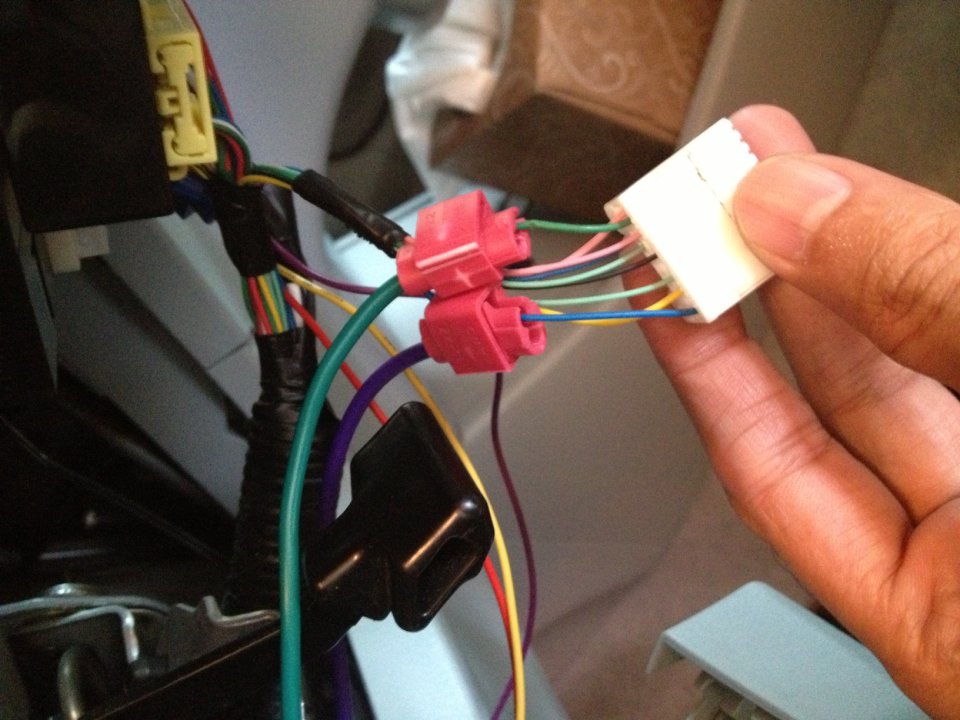

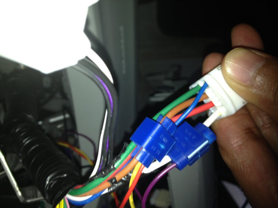

    Folks sorry for duplicate post but need some help asap... the car is sitting all disassembled and not sure if i should just undo it all... my project is in limbo, lights wont turn off and stay on all the time till i shut down the car.
    if someone can help
    i connect all the wires per the instructions but now have 2 issues
    1. the headlight is ON all the time does not seem to be working with the sensor
    2. the on/off switch has no effect on the whole thing
    here are some pics
    Pic 1 shows the violet and green from relay connected to the switch L47
    Pic 2 shows red+yellow going to the brown in my case to pin 2 and also violet going to the white in L48
    Pic 3 the unit and the relay
    Pic 4 the cut off in the loop between the relays
    any Thoughts on what did i do wrong?
  7. Vitaliy
    Vitaliy Junior Member
    Jun 11, 2013
    47
    Did you cut red wire inside DEI module? 545T by default has headlights as DRL, to turn this feature off you need to cut red loop inside main CPU module.

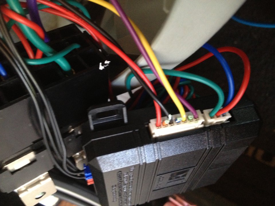

    Intsalling this in a 2012 - current Prius is similar to how @hawkmoon77 did it on a 2010-2011 except that the post facelift Prius has DRLs, the installation is slightly different. Its requires the use of both relays.
    When using just the 1 relay on the headlight circuit with the light stalk on the DRL position, only the headlights are energized, not both headlights & parking lights. If the stalk is left in the off position then both the headlights & parking lights are energized. The down side of using just 1 relay is that u will never be able to use the DRLs.
    So I utilized the 2nd relay to energize the the parking lights. This will allow u to keep the light stalk in DRL mode. There is a downside & a plus side to this.
    The downside is that the light indicator on the dash won't light up letting u know the lights are on.
    The plus side is now the DRLs stay on with the headlights.
    The headlights also turn on with the use of the windshield wiper with this module.
    Here are the wire connections I made for the module harness. All connectors on the Prius is located inbetween the steering column covers:
    Violet (12v + wiper) - Locate the larger connector L48 under the wiper switch. Tap the wire in pin 4 of on this connector (see picture below of connector).
    Yellow (12V+ ignition) - Locate the larger connector L48 under the wiper switch. Tap the wire in pin 2 of on this connector (see picture below of connector).
    Black (12V - Ground Wire) - I connected this to the same ground i previously used when i installed the signal mirrors. There is a 10mm bolt just below the dash that is covered when the foot well cover is on.
    Red (12V + Constant power) - in the driver footwell junction block is a black connector at the bottom of the block. In the black connector is a red wire. This is the constant 12v +. Tap this wire.
    Lastly, i needed to connect the relays. Locate connector L47 under the light switch. Tap the wire in pin 12 & connect the blue & green wires from the relays. Now tap the wire in pin 18 & connect the brown from the relay. Now tap the wire in pin 20 & connect the violet wire from the relay.
    If u have 2 diodes readlly available, then u can use just the 1 relay.
    Taking the green wire from the relay, connect it to the tap on pin 12.
    Take the anode end of the dioedes (the end without the strip) & connect it to the violet wire from the relay. Now take 1 cathode end (the end with the strip) & connect it to pin 18 & the other cathode end to pin 20.
    Yuber814 placed the photo cell in the middle of the dash closest to the windshield.
    I used 1 of the blanks for the bypass switch.
    I failed to get any progress pics so hopefully Yuber814 can post some final pics but in the meantime, here is a quick vid:
