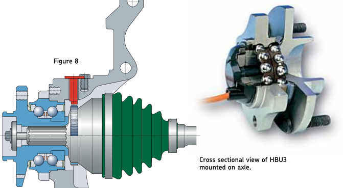

  7. ChapmanF
    28,607
    18,943
    Condensing from another post with more information, if you look closely at how a hub bearing assembly is put together, you'll see why it isn't going to press apart like granddad's wheel bearings, and isn't even a matter of the proper press.
    That said, there seem to be aftermarket replacements that look about the same from the outside but are built out of off-the-shelf bearings pressed together. If the "hub" has already been replaced once with one of those, then there might be a chance of pressing it apart and changing those bearings.
    pollypocket53132 likes this.
  8. GTW
    GTW Junior Member
    May 23, 2018
    55
    23
    Castroville
    ----USA----
    Thank you for this illustration and the reference. I bookmarked that thread in regards to this conversation.
    You struck a good nerve with the Grandad reference. My Grandpa was a machinist, probably did this kind of axle-grease work a lot more than I will ever know. Thank you.
