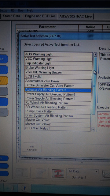

    My problem:
    I did reset the brake lights and I drove the car. in like 2 brake presses the lights came on again accompanished by sharper brakes and when those lights come on I stop hearing the regenerative brake noise.
    So now I know I will have to do brake bleeding as when I was changing the brakes I wanted to check the boots of the rear left wheel and I shouldnt have done it... I opened it fully and fluid came out and AIR in. I closed it succesfully, no leak for the week and more I drove the car but there is obviously air in the system. Also As i press the brakes for normal to moderate stopping from lets say 30 mph to 0 I hear descending clicking noise from rear.... No idea what is it but I hope it goes away after the bleeding procedure
    How to do it? I read a topic with 1 ohm resistor or wire that you need to connect in the OBD2. But I have the techstream working so thats what I am going to do. Only question is exactly how:
    I can see this
    Which one should be first, which one is the main one, as I have rear there is up to 1 gallon of DOT 3 fluid... wow
    Thanks in advance

  19. Georgios
    Georgios Member
    Feb 6, 2018
    126
    85
    Chicago
    ----USA----
    Does someone know a the proper procedure to bleed the brakes. The code i have is 1344
    This is LR wheel cylinder. This is the cylinder i pulled out by mistake. As i wrote before i had some fluid out after i pulled out the left pushing part. I put it back in place and no leaks after that but i let air in the system.
    I read here that the clearance should be adjusted for that specific code to stop coming back. I couldnt bleed the brakes as when i go on the techstream it shows me an error saying some of the requirements are not met...
    Should i replace the cylinder?
