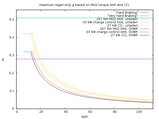

    • The MG2 torque limit is 207 Nm. Given gen 3 liftback gearing and using 314 mm for the effective tire radius, that's 5680 N (1277 pounds) of road thrust, enough to slow an unladen gen 3 (1382 kg per carspecs.org) at 0.42 g, or a fully-laden one (3980 lb GVWR sticker) at 0.32 g.
      As a sanity check on those numbers, this source gives examples of "Hard Braking" (0.28 g) and "Very Hard Braking" (0.51 g). So MG2's rated torque is more than enough to qualify as "Hard Braking". (Even if it can, whether the car would ever apply that much regen without also bringing the brakes into play is a matter of its programming.)
    • The charge control limit, per the repair manual, is "−33 kW or more". (Toyota calls power from the battery positive, power to the battery negative, and by "or more" they mean "or further toward + on the number line" so, for example, −20 is "more" than −33.) The ECU adjusts this value in real time according to battery conditions, so you can't expect regen as strong as −33 kW except from a pretty young battery that isn't too charged or too hot or too cold.
    If CCL is the charge limit in watts at this moment and rpm the rotation of MG2, the available MG2 torque (in newton meters) is 9.5493(CCL)/rpm. That curve crosses the constant MG2 torque line, 207 Nm, at rpm = 9.5493(CCL)/−207. When CCL is −33 kW, that's rpm = 1522 (about 13 MPH road speed). At any higher speed, this limit is less than the MG2 torque rating, so the available regen g is determined by this.
    Those two limits lead to a plot like this as a first effort (again, I'm using gen 3 specifics here):

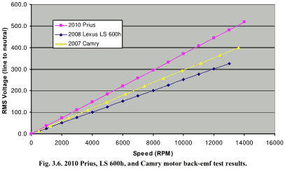

    But that plot neglects another limit, namely, whether those high regen levels at lower speeds are really achievable. A voltage higher than the battery's own voltage is needed to make a battery charge. Figure 3.6 (p. 59) from the ORNL teardown report shows the voltage out of MG2 at various speeds.
    The traction battery has a nominal voltage of 201.6 VDC and is even somewhat higher when charging. There is a "boost converter" that can raise that as high as 650 VDC when needed to power the MGs, and it can also buck high MG voltages back down to battery voltage during regen. That converter doesn't boost in that direction, though, so when MG2 is producing less than battery voltage, that converter can't help. The car has another trick up its sleeve, touched on further below, but an obvious question is what road speed is needed for MG2 to produce 201.6 volts?
    At first glance, fig. 3.6 seems to say MG2 has to rev above about 5500 rpm (47 mph road speed) to produce that voltage. Of course, we know the car can regen at lower road speeds, so the picture isn't complete yet.
    Two important details are in the y-axis label of the graph. The first is that it says line to neutral, and the second is that it says RMS Voltage.
    The three phase windings of MG2 do join at a common neutral, but that's all inside the motor where the car's inverter has no connection to it. The inverter only sees the line-to-line voltages, which (when sinusoidal) are higher by the square root of 3. (That's the same reason a building can have three-phase power that's 120 V line to neutral and 208 V line to line, or 277 V line to neutral and 480 V line to line.)
    Also, the way the inverter's H-bridges rectify the AC waveforms from the motor to DC, the DC voltage reflects the waves' peak, not RMS, amplitude. The peak (not peak-to-peak!) voltage of a sine wave is its RMS voltage times the square root of 2. So taking both these factors into account, the battery voltage of 201.6 VDC nominal corresponds roughly to 82 V RMS line to neutral, and fig. 3.6 shows MG2 only having to hit 2000 rpm to generate that, or 17 MPH road speed.
    (Wait! Doesn't that also mean the boost converter limit of 650 VDC is hit around 6500 MG2 rpm? Can't the car drive MG2 at double that speed? How can it do that? I'm pretty sure the answer involves field weakening.)

    So the car is able to keep doing some regen even below 17 MPH and right down to single-digit speeds. But the limits at those low speeds may be lower than my g plot above suggests.
