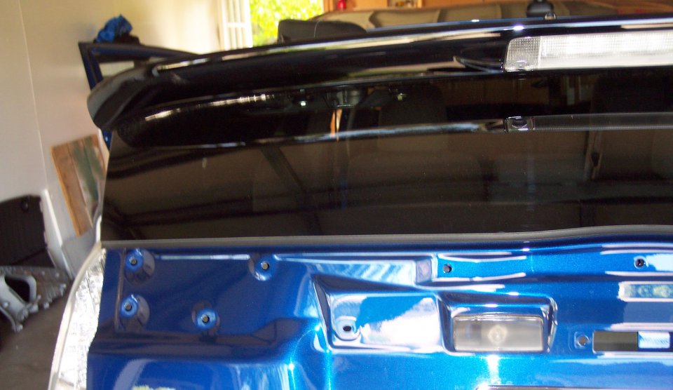

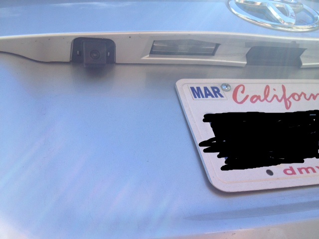

  4. SoCalBPrius
    SoCalBPrius Active Member
    Jan 8, 2012
    563
    118
    SoCal
    Thanks for the link zebelkhan. A little confused in the ebay description it says to install in the license plate light but my blank (to install the backup camera) is slightly left of the license plate light. Would u be able to snap some pix. preferably, some close up to see the detail & fit & from a little distance where I can see the whole rear of the prius so I may see the vantage point of the backup camera location?
  5. zebelkhan
    zebelkhan Member in good standing
    Mar 14, 2012
    165
    38
    Morgan Hill, CA

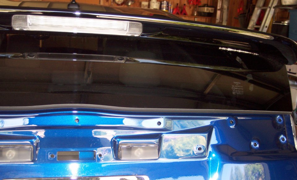

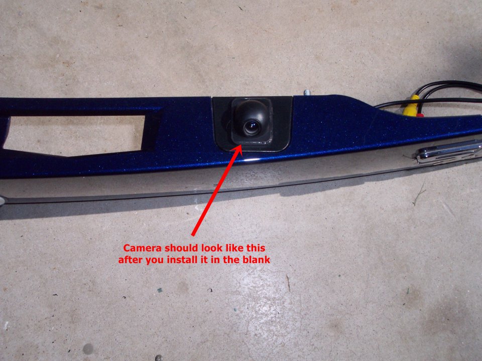

    Instruction are not that good so ignore them. Camera installs in a location that is to the left of the license plate light. See attached pictures.

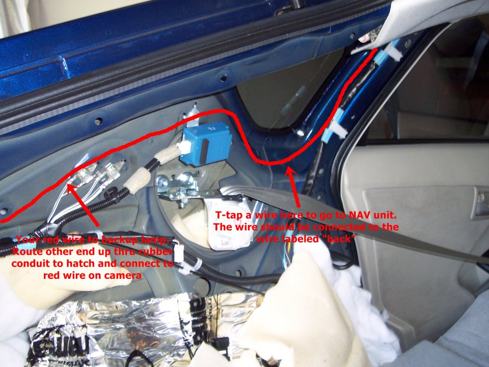

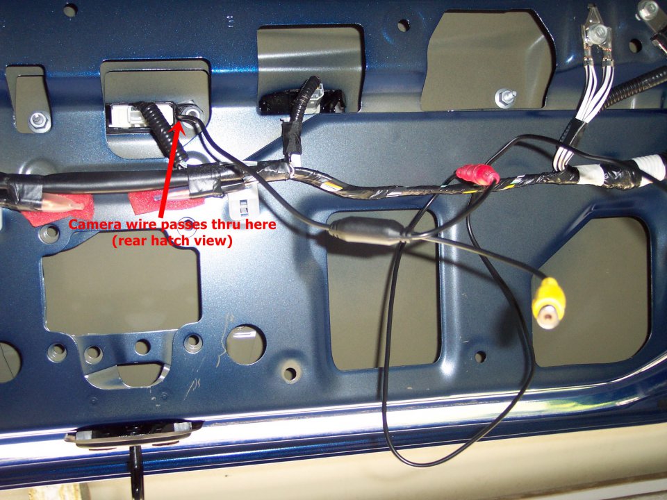

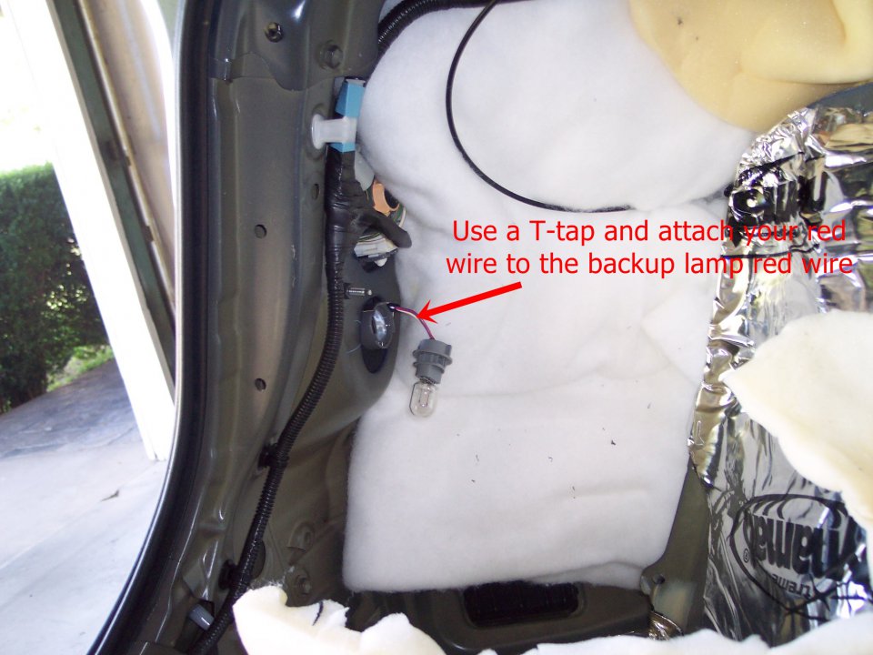

  12. phoenixgreg
    phoenixgreg Senior member
    Apr 7, 2010
    1,157
    295
    66
    Phoenix

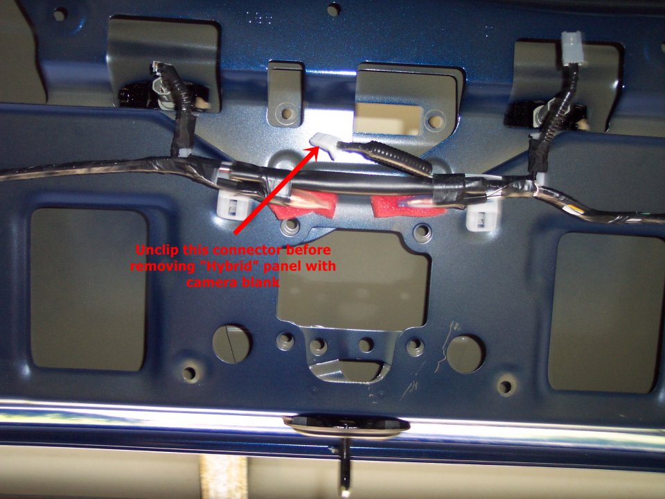

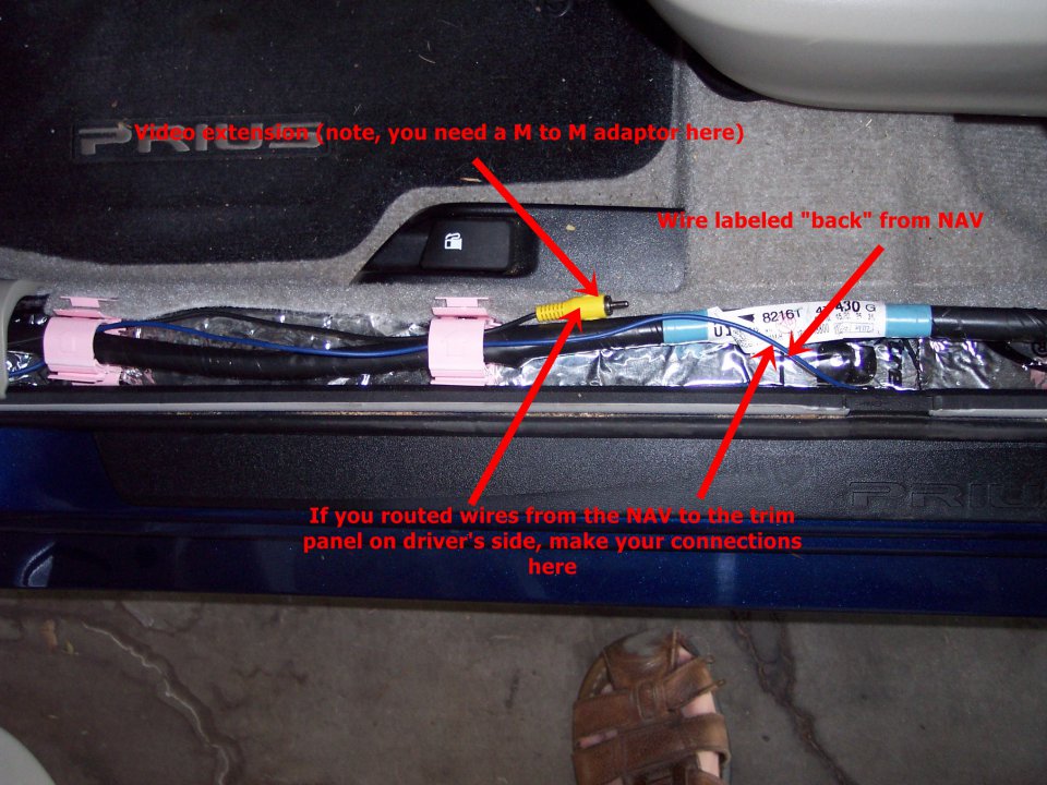

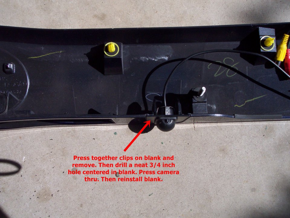

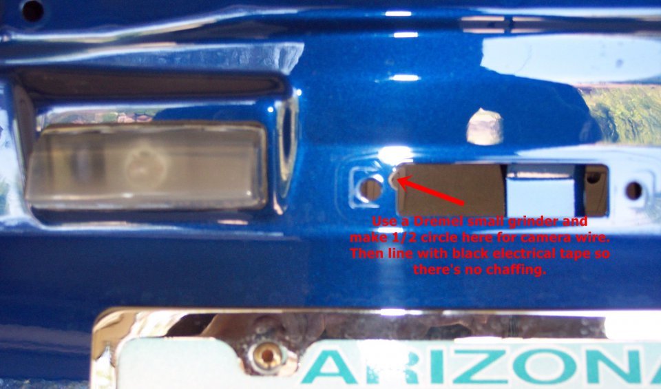

    Here are some pics of my install to an aftermarket NAV unit (Myron & Davis):
    Rear camera attach a red wire here.JPG Rear camera attach a red wire here.JPG Rear camera grind small area for wire to pass thru.JPG Rear camera hybrid panel reinstalled with wire.JPG Rear camera inside hatch panels removed.JPG Rear camera outside view 1 hybrid panel off.JPG Rear camera outside view 2 hybrid panel off.JPG Rear camera pressed into blank.JPG Rear camera route a red wire here.JPG Rear camera view from under hybrid panel.JPG Rear camera wiring under carpet trim.JPG
