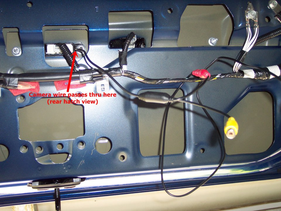

  3. sang kang
    sang kang New Member
    Jun 10, 2013
  4. sang kang
    Jun 10, 2013

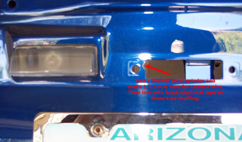

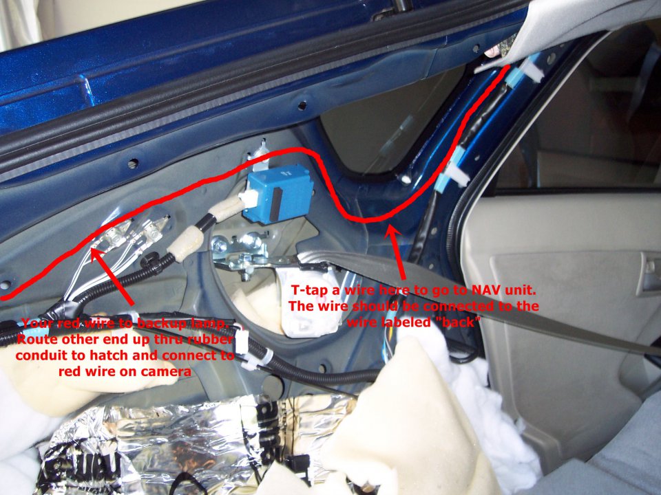

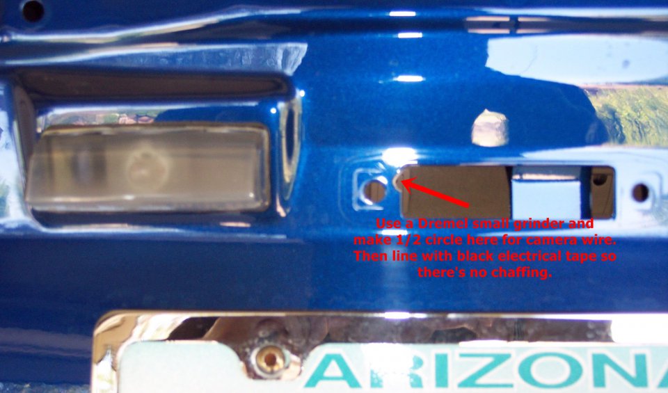

    If you strip off the camera wire to the bare, three wire can pass the plate light assembly with a really tight fit. However, dremmel would seemed to be prudent course of action.

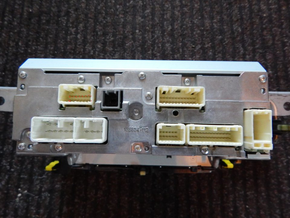

    Hi! I have Toyota 2012 Yaris XP13 (French made). I install Toyota Touch HU and I would like to have rear camera.
    I buy eom camera but my yaris has no wiring harness for rear camera.
    I have no L148 connector, and pin 2 L149 is empty.
    Today I power camera with 12V, now I see it needs only 6V :(
    I have question to all of You how we number pins in HU.
    Here is pic of my HU:
      File size:
      108.2 KB
      Views:
      827
