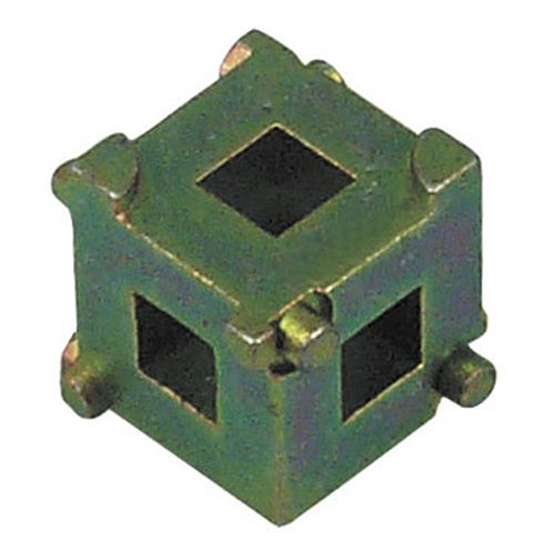

    I believe you need a certain tool to work the rear pistons back into the calipers if you're replacing the pads.
    From page 33 of that attached pdf:
    The manual covers piston removal, which should not be necessary, but notes using the mysterious SST to work them back clockwise. They have that X pattern on them, so you can file a mating surface into an old 1 inch socket if you want. I believe you have to turn, but I'm NOT sure. You definitely have to push, though, and not just turn.
    Michael Wood likes this.
  14. schmuber
    schmuber Member
    Oct 9, 2018
    115
    85
    Georgia
    Google "Lisle 28600". It's a small cube-shaped attachment for your socket wrench extension. And yes, you push and turn that wrench by hand.

    38
    Evansville, IN
    If you have an AutoZone in your area, part number 27111 is a comprehensive loan-a-tool that will do just about all vehicles. And if when rented, you like it, it’s yours to keep.

    Also called a dice;).
    It comes in handy from time to time(y).

    Harbor Fright has their version, too. Item 68972.

  19. Mendel Leisk
    61,601
    42,373
    Just google brake tool, it should show up. Add "cube" narrows it down.
    You can rotate it just with needle nose pliers tips, but it's awkward and difficult, especially to screw it all the way in.
