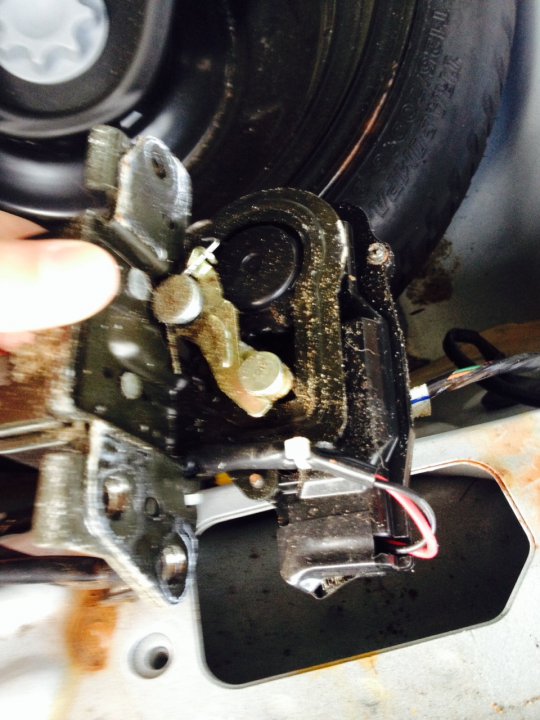

    Is this the motor?
  12. Patrick Wong
    Patrick Wong DIY Enthusiast
    Mar 8, 2008
    18,210
    6,517
    Green Valley, AZ
    Yes. The repair manual suggests the following test. When viewing the wiring harness connector with the latch on top and the metal terminals facing you, terminal 4 is in the lower left and terminal 3 is in the lower right.

  15. Mr.Electric
    Mr.Electric Member
    Jan 18, 2011
    287
    106
    San Francisco
