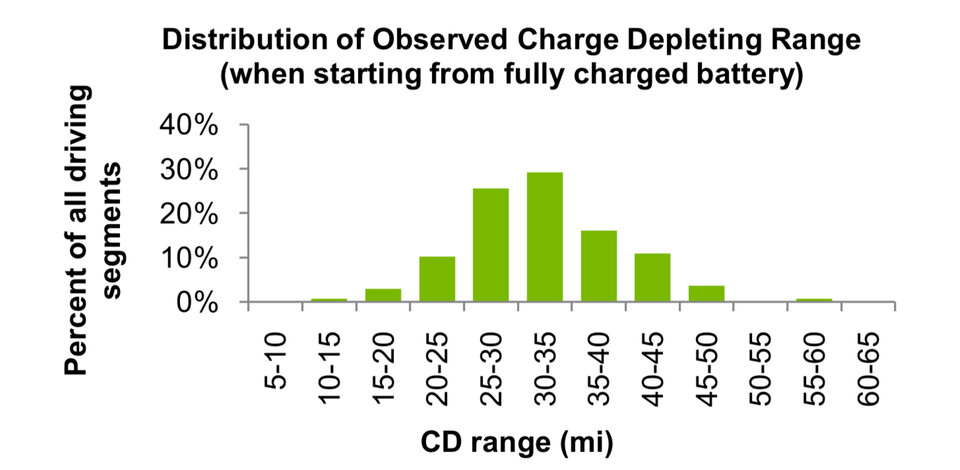

    There was a company that added their "Hymotion" 5kwh batteries to gen2 Prius for $10k 15 years ago. Those conversions might have reached 48 miles ev range if the speed was very low, maybe 25-40 mph. Over a period of time that range would drop to somewhere around 10-15 miles. These range figures were in warm ambients with no heat or ac used.
    The government ran tests and logging on over 200 of these conversions.
    This is what that group of personal users got with a full charge.
    If an individual tried to engineer a similar setup on a gen3, the results are unlikely to be that good even though the battery parts cost would be less.
    When you stop and think about it, a brand new Prius Prime plugin still gets 44 miles range but is capable of freeway speeds unlike the gen2 conversions or a gen3 factory plugin on ev alone.
    Gen2 Conversion Study
