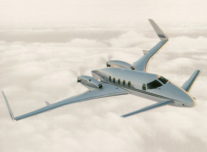

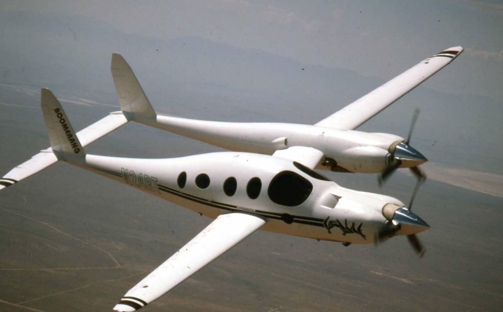

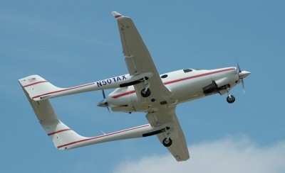

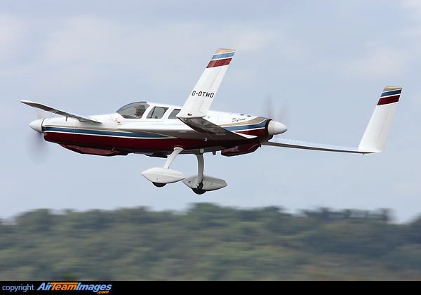

    You'll note that the vast majority of the commercial airline fleet is twin engine aircraft, NOT three or four engine aircraft, which a few decades ago were much more common. The trend is to REDUCE the number of powerplants, both making the airplane simpler to manage and less likely to break down. Within another decade I wouldn't be surprised to see 747s and the Airbus 380 retrofitted as twin engine aircraft, all in the pursuit of increased efficiencies as well as safety.
    The engineering ideal would be single-engine - but a lot of legal and popular prejudice would still have to be overcome long after it had been made feasible from an engineering standpoint.

    Funny, isn't it, how often 'conventional wisdom' is just plain wrong?

    Those are cool planes! But other than the ones with the props in the front and back, you will be unbalanced with just one. Your yaw will go crazy.

    Can go crazy... but if you pay attention, and the weather isn't pissy, you can handle most all twins with one engine out... although I will say, I am not multi-engine certified, I have flown a Dutchess for about 45 hours...
