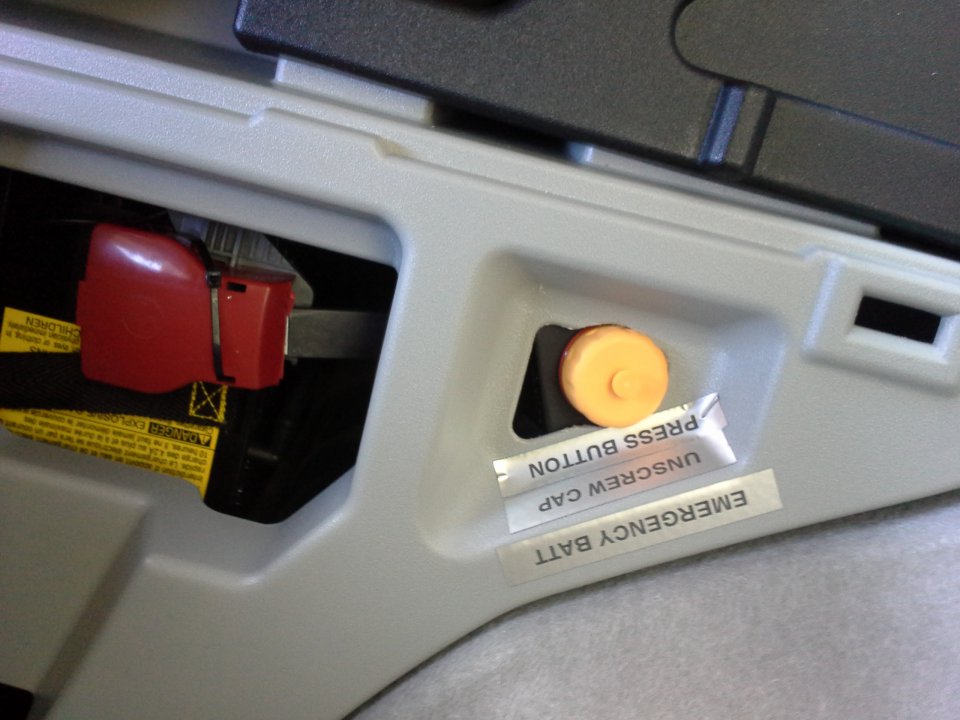

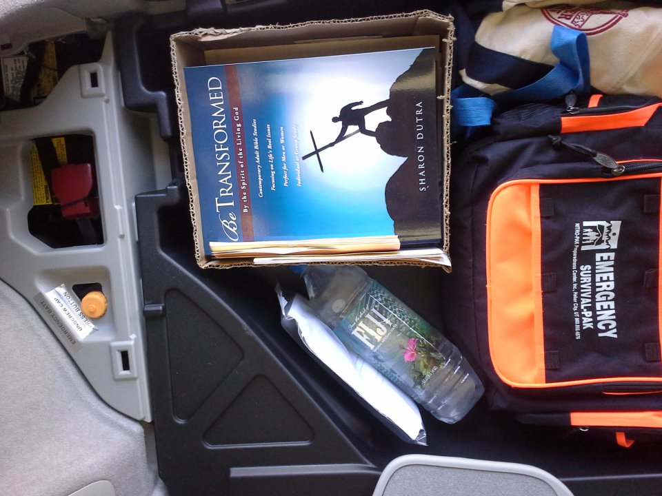

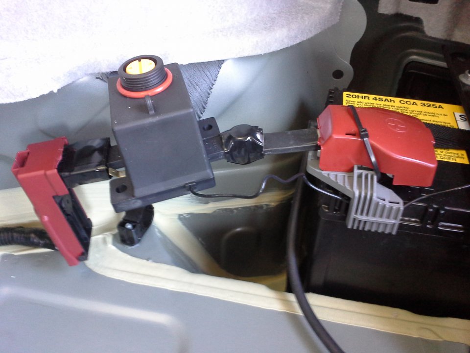

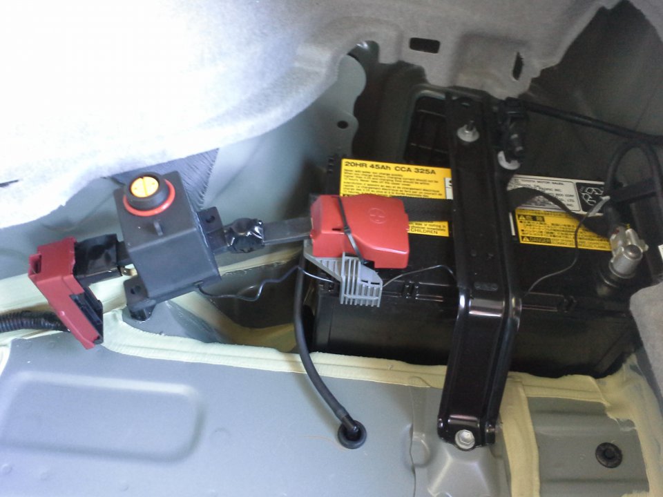

    I saw so many threads of concern here on Prius Chat over the 12vdc Prius battery going dead during long storage, or not being able to start the car due to old battery age - low voltage. So I decided to do something pro-active to prevent this seemingly common problem. I bought a "Battery Brain T1 protector" from Amazon that monitors the 12vdc battery voltage, every 2 seconds, and electronically disconnects the car, from the battery if the voltage ever drops below 11.8vdc. The Company that makes them, (STRS Energy Inc.), says at that 11.8vdc voltage, you should still have enough "reserved power" to start the car by simply pushing the reset button on the Battery Brain, to reconnect it back to the car when you need it. So if we leave a door open, leave the lights on, or even if the battery is getting too old and falls below 11.8vdc, we now have a warning, and a quick solution to the immediate problem, simply push the reset button, and we should be good to go. With the included versatile installation parts, I was able to mount the unit in a perfect location so as to not even have to remove the battery cover, to be able to press the reset button! It just took a minor dremel modification to round out the slot on the battery cover to get the Battery Brain button and cap to fit perfectly. I also had to remove the battery cable from two holders in order to relocate the cable connection further out. All in all, about an hour to complete the job - mostly due to being too cautious with measurements, and unknown installation location planing time. Sorry, some how the last two photos were turned upside down after uploading them.:notworthy:
