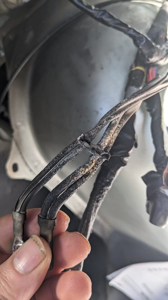

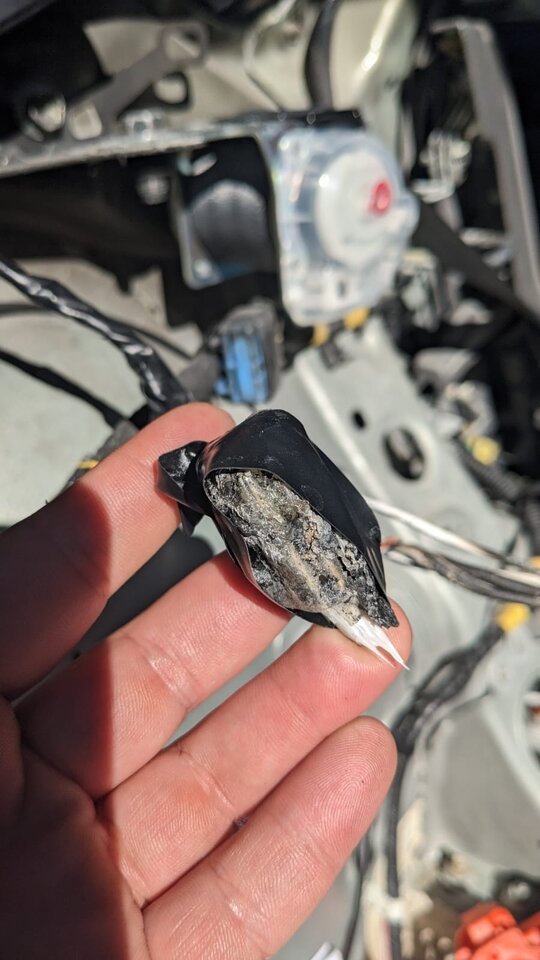

    Also, things melted? Pics for reference. All of these wires and connectors are near the door control receiver. The white and black wires are grounds.

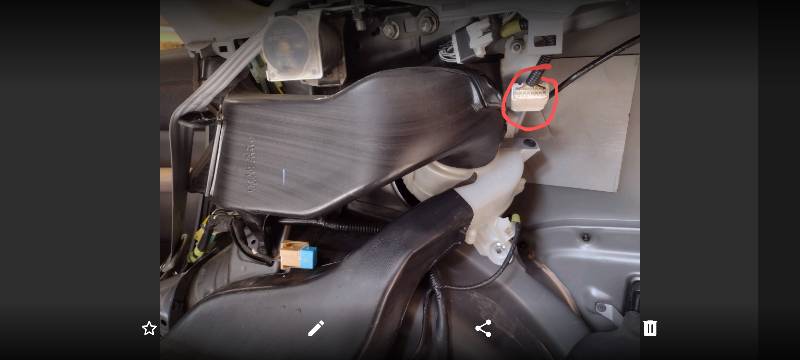

    This is in the trunk near the battery cooling fan show me the cooling fan and it's a little plug the white one and all that in the right side rear quarter just forward of the 12 volt or above the 12 volt All of that is right there I'm not sure where all these wires that are burning are are in relation to what's not working The black box with the red label it's not real familiar to me because they probably never get touched or worked on I realize what it is but this should be an indication of what caused that to burn up somewhere near the stuff back there whether they were sitting against something that was getting very warm which I can't imagine what that would be your battery and modules are covered with a case etc.

    Yeah so these burnt wires are on driver side in the trunk. I checked that the fan operates when power is applied, the 1 and 2 pins in the battery connector have continuity between the 3 and 4 pins of the temperature sensor in the airway (not sure thats what it's called). I have not been able to see continuity between the battery computer connector and the 2 pin connector at the fan. Which led me to remove the panel at the driver side read and discover the melted mess behind it. So i went looking for a replacement harness but I cannot find any parts diagrams to help me locate the part number. Thinking about applying a switch, lol.

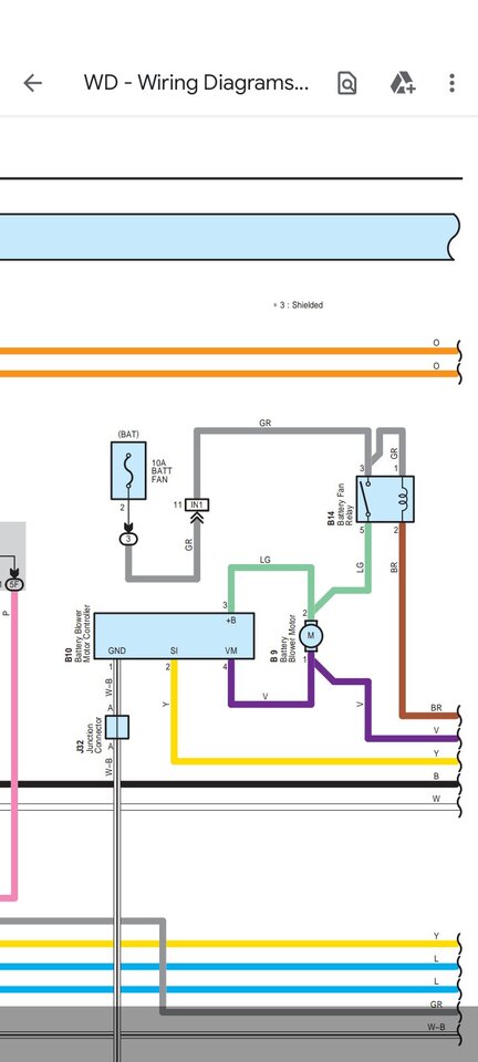

    The most common cause of battery fan problems is corrosion at connector BM1 due to body seam leaks around the tailgate.
    While the battery ecu does monitor fan negative as a feedback, it controls that negative side via a motor controller (transistor).
    Fan positive goes through a relay (ecu controlled - is the blue cube in the picture) and doesn't go to the ecu.
    The brown, violet, and yellow wires go through BM1 to the ecu.

    What model Autel scantool? It might "disallow" the test if the ecu sees a fault with the circuits. I can unplug the fan but it won't set a code until it tries to turn the fan on.
    Clear the code and use a DVOM to check for 12V power at the fan (light green wire) or the fan control module while commanding it on with your scantool.
