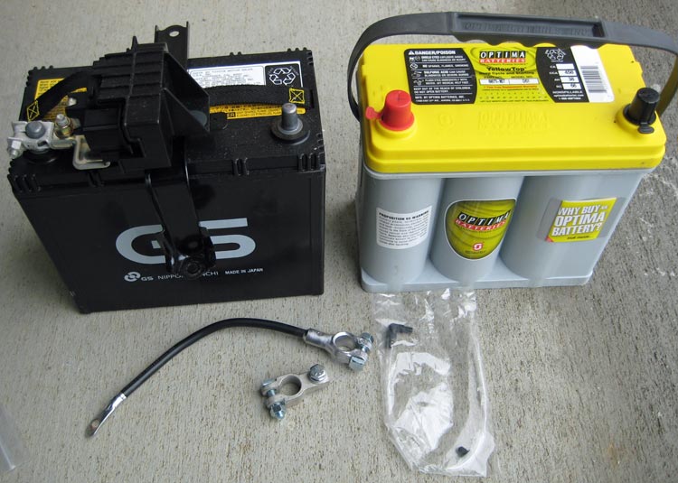

    what is the capacity AH from the oem vs optima?
  2. darelldd
    Jan 17, 2006
    6,059
    389
    Northern CA
    The height is identical as you can almost see from here. For all intents and purposes, they are the same dimensions.
    Not sure what the original is (doesn't say on it - at least not in English!), but the new one is rated a 41 A-hr.

    Hey Darell,
    It is a nice write up...helps to have this battery change stuff in several places b/c my Alzheimer's makes it hard to remember who has various write ups for different Prius stuff.
    I did notice this line:
    Besides the price and effort, the only downside here is losing your MPG reading and your radio stations. :)
    You might make a note that suggest hooking the under-hood jump points to one of the jumper boxes or a charger while you're doing the battery exchange so that you don't lose the presets and such..that's what I did and it worked like a charm. You could never tell the old battery was detached.​

    Evan - Great point. And when I did the Optima swap in the Rav4EV, I did just that. Go figure. The nice part about keeping power to the Prius is that you don't have that pesky positive lead flopping around on you to worry about shorting.

    Yeah... you'll notice that I didn't get much love on that Stinger thing. And when I learned that the D51 was taken off the market and brought back (repaired, in theory) I was much happier with that plan.
    Last month it was $10. Then $15. Now $29? I get the sneaky suspicion that I may be partly responsible for that. My Optima page has gotten lots of hits, and many have followed my e Learn Aid like. With all that extra attention, it might have seemed wise to raise the price. :( I thought $10 was about right. $30 is definitely getting a bit steep for what you get!
