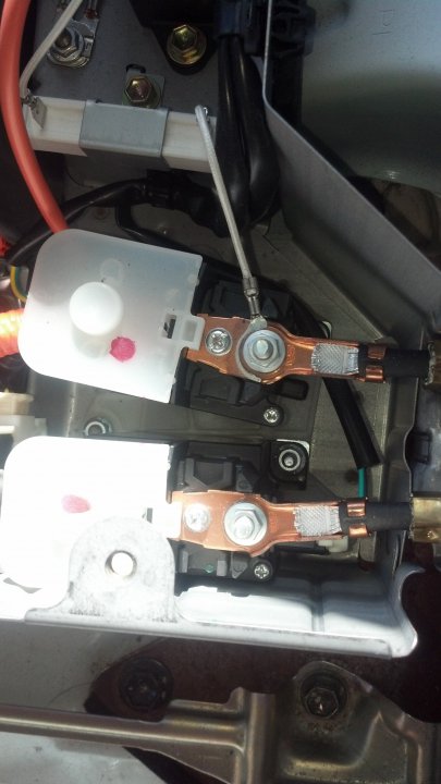

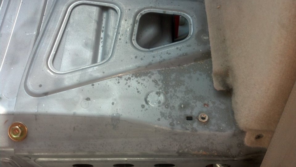

  19. heyomateo
    heyomateo New Member
    Aug 27, 2013
    Belton, Texas

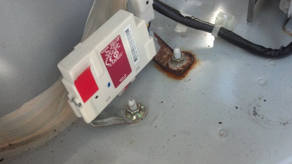

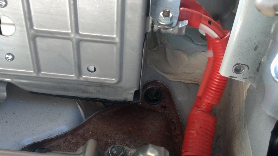

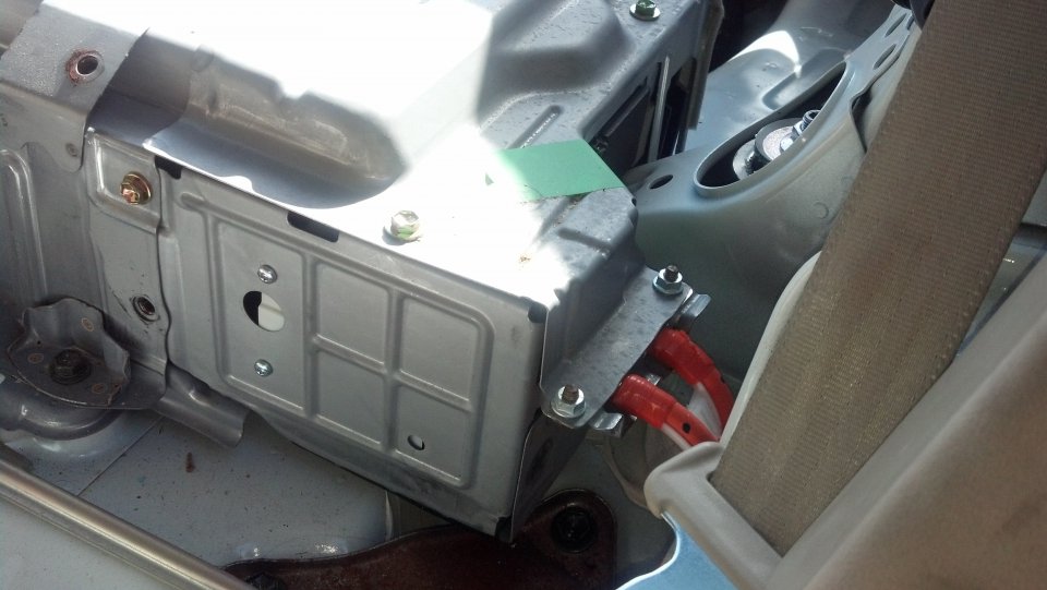

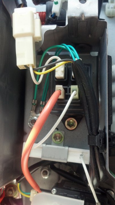

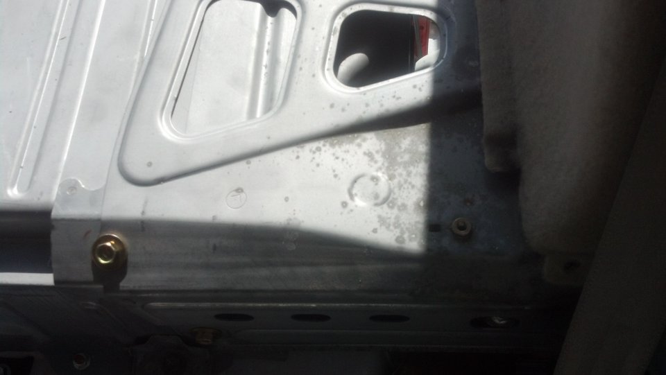

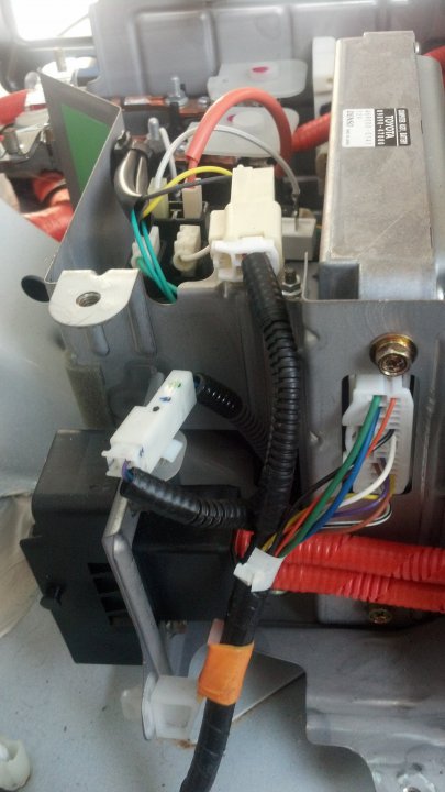

    Thanks, everyone. This is really helping me narrow down what's wrong with my Prius. I was able to visually inspect the battery today, and did notice some corrosion around the battery, but none on the actual unit itself. I have attached some pictures of the battery assembly. At this point, it seems most likely to be a relay.
    IMG_20130828_103241_718.jpg IMG_20130828_100419_405.jpg IMG_20130828_100438_992.jpg IMG_20130828_100444_558.jpg IMG_20130828_101031_188.jpg IMG_20130828_101133_690.jpg IMG_20130828_101041_904.jpg
    Greg Grieve and uart like this.
