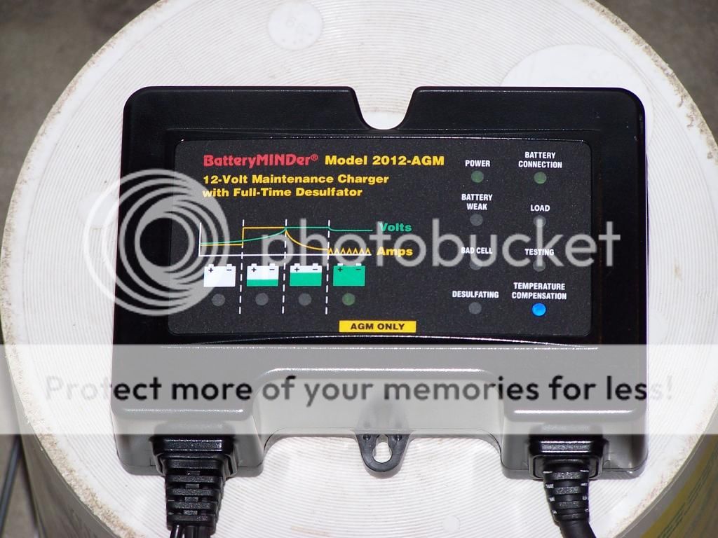

    Like others who have posted on this forum, we don’t drive our Hybrid Avalon and Prius cars enough to keep their expensive 12V Absorbed Glass Mat (AGM) batteries fully charged and healthy. I had been periodically hooking up my 1992 vintage automatic 10/2 Amp battery charger to keep them charged, but I was getting tired of doing this, especially this winter. I have also come to understand that AGM batteries benefit from a different charging profile than regular flooded batteries; and, it is possible to shorten the life of an AGM battery by using a charger not designed for AGMs.
    Based on recommendations in this forum and elsewhere, I purchased a “BatteryMINDer Model 2012-AGM, 12-Volt Maintenance Charger with Full-Time Desulfator”. The 2012-AGM is only for use on AGM batteries, so I also bought a standard BatteryMINDer 2012 for the flooded batteries in my two tractors. Both the 2012 and 2012-AGM are 2 Amp chargers. BatteryMINDer also makes an 8/4/2 Amp model 12248 that will charge both AGM and non-AGM batteries, but two separate units are more convenient for my use. Both the 2012 and 2012-AGM work as advertised. The 2012-AGM takes about two hours to go through its charging routine and completely charge an approximately 50% depleted Prius Optima battery. After the battery is charged, the charger can remain connected indefinitely to automatically maintain it.
    The 2012-AGM was $75.00 on Amazon, which is less than the $99.95 price on the below BatteryMINDer website. The 8/4/2 Amp model 12248 is $135.00 on Amazon. Also, if you want additional cables and connectors, the Battery Tender accessories on Amazon are functionally the same as BatteryMINDer accessories and a lot less expensive. I use a Y-connector, DC extension cable and a second battery clip cord set to maintain both my flooded tractor batteries with a single 2012 BatteryMINDer. I can also maintain both AGM car batteries with the single 2012-AGM using the same accessories. The 2012 and 2012-AGM can simultaneously maintain up to six batteries that are connected in parallel configuration.
    BatteryMINDer 2012-AGM : 12Volt 2 Amp (12V 2A) Charger/Maintainer/Desulfator For Optima & Odyssey & Other Specialty 12 Volt Sealed AGM Lead-Acid Batteries (World Wide Usage) - VDC Electronics
    I posted this information about the BatteryMINDer to benefit other Prius owners in similar circumstance. I don’t have any interest in promoting BatteryMINDer products. There may be other AGM battery maintainers out there that are less expensive and serve the same basic purpose. Below are pictures of the BatteryMINDer 2012-AGM hooked up to my Prius.

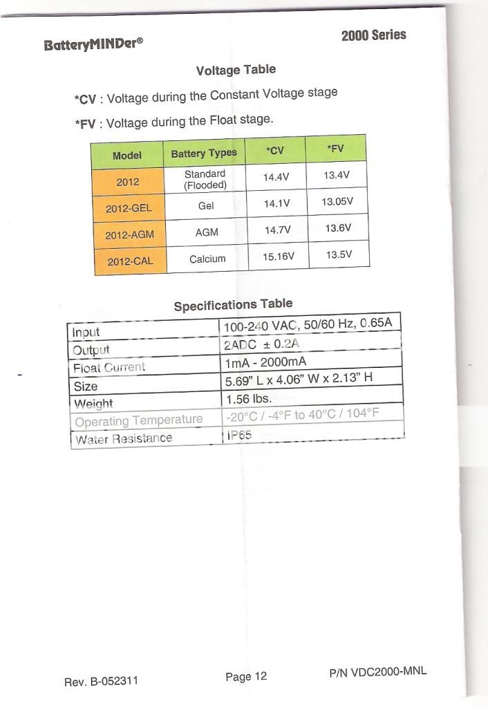

    This same subject came up on another site, where a fellow posted that the 12117 float output is very slightly below the ideal float voltage for an AGM battery. ( I believe he said 2/10 volt below ideal)

    Below is the “Voltage Table” from page 12 of the BatteryMINDer Instruction Manual. It shows the same .2V difference in Float Voltage (FV) between standard (2012) and AGM (2012-AGM) that you mention above. Also, on page 9 of the manual it states that the Constant Voltage (CV) charging stage ends when current falls below 0.5A for the non-AGM charger, vs. 0.1A for the AGM.
    The difference in charging profile between the AGM and standard (flooded) charger/maintainers is one of the reasons why I chose an AGM specific model. BatteryMINDer, Optima, Schumacher, etc. now make chargers/maintainers that are designed specifically for AGM batteries. It may not be a critical difference, but my thinking is that if multiple charger manufacturers think it is worth the additional development, marketing and logistics expense of selling a specialized AGM model, it is probably worth buying if you are in the market for a charger/maintainer for an AGM battery. Again, I am not an expert, but it made sense to me to buy an AGM charger/maintainer designed specifically for my expensive AGM batteries.

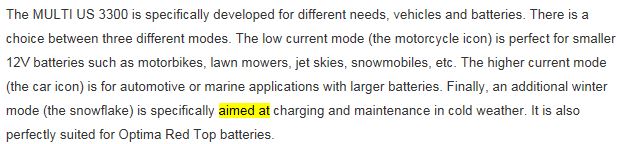

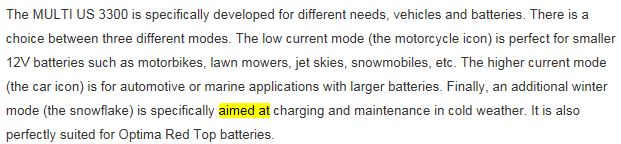

    I've got a CTEK 3300. It has 3 charging modes icons: "motorcycle", "car" and "snowflake". I've always used the "car" mode with the AGM battery in our Prius, but am wondering if I should try "snowflake".
    The CTEK documentation is pretty hopeless, here's one quote from their site:
    Maybe someone can weigh in on this? I believe "snowflake" charges at slightly higher voltage, may be suited for AGM batteries?

    I suspect your right about the snowflake setting being the right one for cold weather charging and charging an AGM battery.

    Mendel,
    I agree with Jon Hagen's thought about the "snowflake" setting for AGM. If you look at the BatterMINDer's temperature compensation table on page 11 of the above attached manual, it shows increasing the voltage to compensate for lower (snowflake?) temperatures. Of course, the safe approach would be to call or email CTEK and get their advice.
