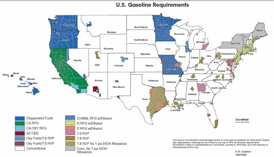

    The short answer is: E0 does *not* satisfy Clean Air Act requirements. The Clean Air Act (1990 Ammendments) requires that certain Metro regions must use so-called Reformulated Gasoline (RFG). All RFG now contains E10 (used to be ethanol or MTBE). That RFG region includes most of the East Coast thru parts of Virgina, CA, Houston, Dallas, Chicago area, and St Louis region. My guess is maybe 50% of Prius Owners live in a RFG region (including me).
    More recently, during the Bush Admin, another law was passed to start requiring renewable fuels (E10) in ALL areas of the USA. The purpose of this bill was not to reduce emissions, but to reduce dependence on foreign oil. In non-RFG regions, some smaller companies are exempt from the mandate to blend E10 in all fuels. Larger companies may have also some flexibility to make a little E0 if they are meeting ethanol quotas or paying for ethnaol credits, which by the way quotas have not even been set yet by EPA for 2014. It's a hot button item.
    Slightly longer answer:
    Going back to the Clean Air Act 1990 Reformulated Gasoline decision to mandate 10% ethanol or MTBE to make gasoline burn cleaner, well, that was an extremely controversial so-called "bad science" decision by Congress. Congress/Industry had established a joint industry R&D program to measure auto emissions, and the new R&D data was basically showing that ethanol was NOT really required to make gasoline burn cleaner. This was an unexpected R&D outcome for Congress who then moved quickly to mandate ethanol/oxygenates despite the weakened case for actual need as far as emissions reduction. Fairly obviously, Congress wanted to go with ethanol for politcal reasons too.
    PS- Greg I see you are in Canada...I am less clear on Canada rationale
