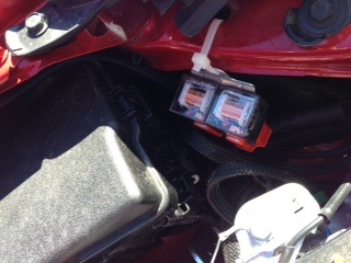

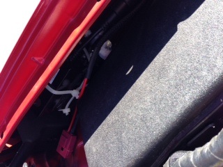

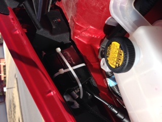

    I pulled the plastic panels off and drilled 4 holes and used a zip tie both ways so ballast would not slide out. Not best fit or look but only decent place to mount. Ran the wire over the front under the edge of the black plastic cover. Will try to post some pics tomorrow if that will help. Did cut hot wire connector and bought a 1/4 inch (.25) female connector like other post recommended. Will type up more detailed info tomorrow for you. With pics

    Let's see if these pics load
    Had to use white zip ties but did the job
