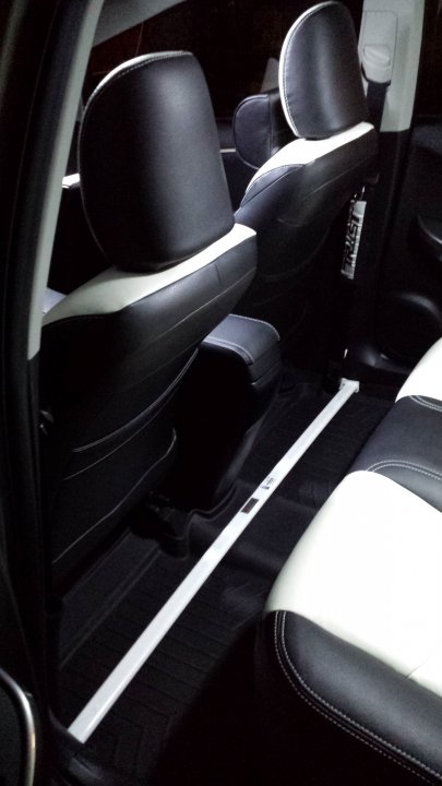

    17s and these suspension upgrades.
    Also Cusco Undercarriage upgrades if you want an even stiffer ride.

    link to where you got the first two (the white ones) from?
    (actually, that's pretty much exactly what I was looking for a couple weeks ago & was unable to find nething like that)

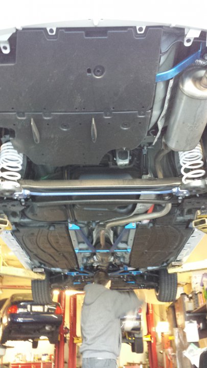

    Thanks, the pics are very helpful. Does an RSB lower the lowest point on the underside of the car? In other words, if I install it and I'm driving in snow, does the RSB run the risk of catching/dragging when the underside of the car might otherwise be able to clear the snow? I just can't tell if the bar is lower than other parts of the cars underside so thanks for any clarification.
  10. Xterra72
    Xterra72 Senior Member
    Oct 20, 2013
    1,437
    1,684
    Cusco bar. ...

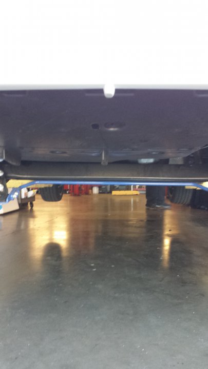

    That pic is extremely helpful. Hmm. Looks like the ends are a bit lower. Not sure if you're in an area with snow or if that has been an issue. I'll probably do it anyway because it doesn't look like a huge issue for the rare occasion I'd be in snow that is high enough to catch the bar but not so high that I couldn't actually drive... a rarity. But, nice to go into it knowing what to expect. I would welcome any additional feedback you might have on the issue of drag or catching on anything, either personal experience or things you've learned elsewhere. Thanks again very much!

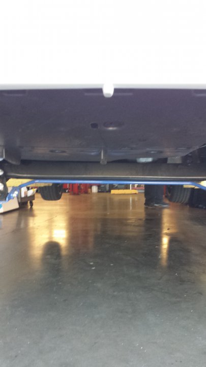

    I went with Cusco because I thought they tuck up nicely to the bottom of the Prius. Which is best since I was going to lower it. Plus they make a matching front sway bar and more......
    Sorry I have no experience with driving in the snow, but I've creeped over some mean speed bumps without hitting them.
    Here's some old B.C. pics. Lots of clearance.

    Thanks very much. These pics help even more. Seems like they don't change the clearance in any measurable way. Cusco it is!
