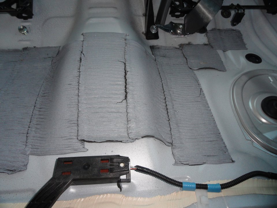

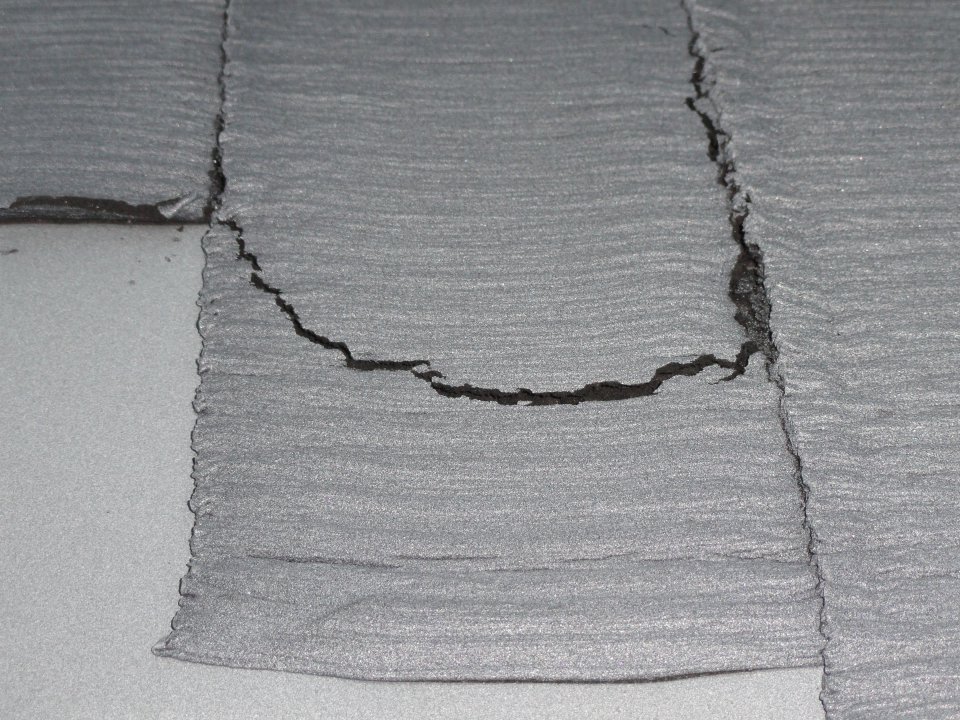

    As with the rear being a trailing arm and that no loads are transferred, take a look underneath the rear seat cushion to see stress cracks from everyday driving :eek::eek::eek:

    My point about the rear brace is not needed as the rear isn't a strut thus the stress is not transferred to the shock tower.
    Not sure how that photo translates to needing a trunk brace as that's in the center of the car. And isn't that insulating/rubber tape?
