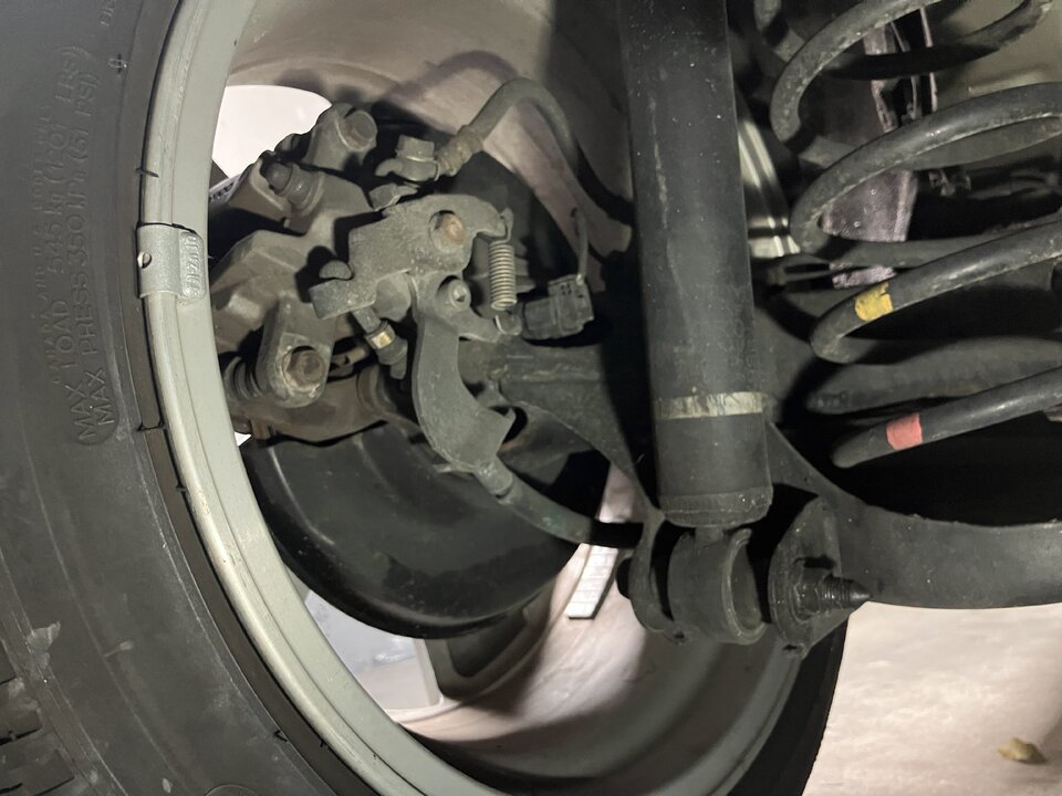

  9. Mendel Leisk
    61,611
    42,383
    Most every rim we've got has a combo of stick-on weights for the outside, and clip-on for the inside.

  12. Mendel Leisk
    61,611
    42,383
    One of our rears, a Costco install, outside adhesive weights and inside clamped-on weight both visible.
