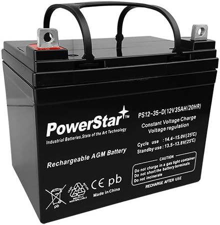

    I purchased a deep cycle 35AH AGM motorcycle battery that has flag posts on it. Obviously the prius uses JIS connectors. Now, keep in mind, I am NOT mechanically inclined WHATSOEVER, I am HORRIBLE with tools. It doesn't matter how many youtube videos I watch, it is just something I am not good at. With that in mind, what would be the easiest way to make this connection work? Would it work to drill through the JIS connectors and put my screw/bolt through that hole and through the hole on the flag post?

    Not sure what you mean by "flag posts?" Can you share a link to what your terminals look like?
    In general I've found a big washer on the top and bottom of each battery terminal in your Prius will allow you to sandwich the terminal between them and bolt it down.

    Flag terminal:
    You could get some adapters like these: Flag to Post Adapter. These likely will be SAE posts, so you might need to file them thinner to make JIS posts - caution! The lead filings are potentially toxic, handle and dispose of with care. I couldn't find any JIS sized adapters.
    Another option would be to use the existing bolt and clamp and undo the nut, open up the gap, sandwich the flag terminal between, then bolt it back up. That may not be possible, due to space, with the flag oriented as shown above.

    This is the exact battery: [​IMG]

    The terminal clamps have a bolt and nut which you're supposed to tighten when you place the clamps over the battery terminals. You can use that bolt to go straight through the flap post, thereby attaching the clamps from the side, rather than actually clamping them onto anything. You may have to use your own bolt and nut. Maybe add washers.

    You could get a couple of these copper pipe clamps and use a nut and bolt to attach them to the flag posts. You will probably have to drill all the holes a bit larger. The positive one will bolt right on to the car's connector once you remove the battery clamp from it. The negative side could be attached with a cable that has ring terminals on either end as long as its an 8ga. cable at least. It is not science of rocket by any means. As long as you have good connections, the car will never know the difference.
    And make sure you get a dirty chunk of 2x4 to put under the battery hold down since the 35ah battery is slightly shorter than the original.
    This solution is no worse than most of the battery terminals I've seen in cars, especially the kind with the 2 little bolts on top that clamp down on crusty green frayed cables.
