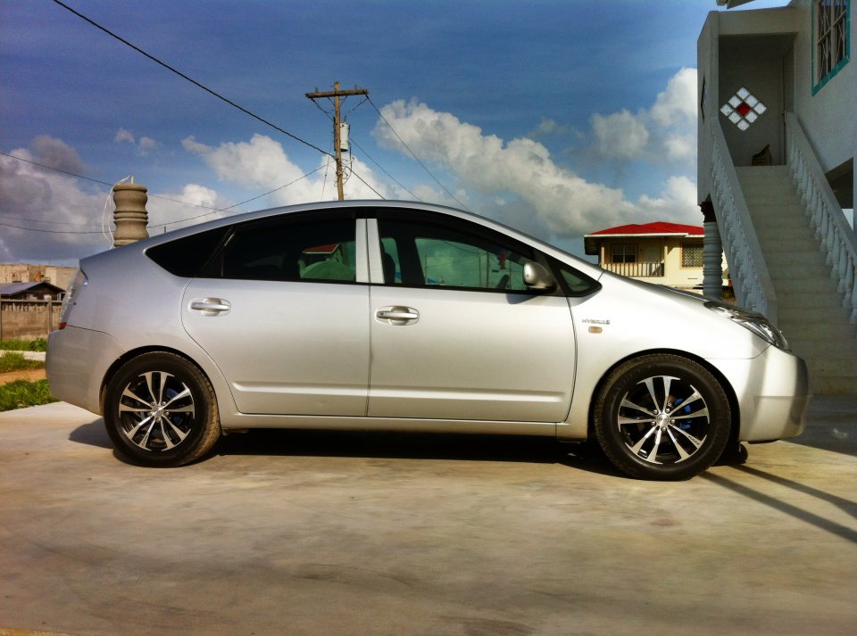

    Here is a pic of my car with 16x7 in League alloy rims and 215/60/16 Yokohama Geolander tires (these are typically used on Camrys I think).
    TheLastMojojomo, offib and Cosmin like this.

    I agree with Riaz as I have recently put Toyota 'Will' mags on my 2004 Gen2.
    Previously the speedo was way out but now with 215/60x16's Kumho Ecowing KH30 it is almost exact when checked with a good GPS.
    Similar problem with it touching under the guards, would be interested to know more about the rubber dampers in the springs to limit travel.

    Nice rims! I am thinking of upgrading my tires on the stock 16' touring rims to 215/60/16. Do the wider track means it rubs the fenders during full lock cornering or only during big putholes? I am only interested in larger tyres because the speedo is off by 6 km/h.

    It won't rub during full lock turning but they will hit the front fender plastic liners and bruise them if you hit bumps or dips at high speeds. Also the the back tires will scrape the sharp edge of the back fender under heavy load and high speeds. The car is still drivable under normal circumstances but these things can be annoying and causes you to exercise more caution when driving. I plan to change to 205/60/16 when these tires are done...that should be perfect.
