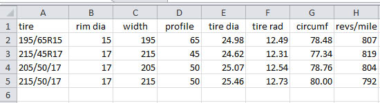

    Yes.
    The OEM 17" (215/45R17) are wider and lower profile (tire height 45% of the 215 mm width). The lower profile is enough to make the outside diameter at face of tread less, to the tune of 1~2 % more revolutions per given distance.
    In other words, with the 17" setup the wheels are spinning a little faster at any speed.
    Some people are replacing the OEM 17" with 205/50R17, which is virtually the same OD as 195/65R17, actually slightly bigger.
    (the above's just extrapolating from the tire data. Reality, especially revs per mile, might vary a bit.

    While I agree in general, I wanted to point out that the official ratings for revs/mile on the above tires are:
    215/45/17= 844
    205/50/17=828
    195/65/15= 829
    Each model will be slightly different but most are within 2-3 of the numbers I listed. :)
    Yes, 215/45/17 tires are smaller in outside diameter than the 195/65/15. Don't let the wheel diameter trick you.
