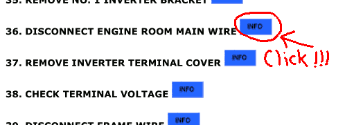

    The Toyota Repair Manual is like that end-to-end. Even basics like spark plug replacement:
    Spark plug inspection and spec in one section, spark plug torque way off in another section, lumped in with valve cover, and the procedure for removing wipers, their motors and the windshield cowl, off in another zone. All unreferenced to each other.
    danlatu likes this.
  16. ChapmanF
    27,618
    18,214
    Completely unreferenced, except for the little blue buttons that jump right there when clicked....
