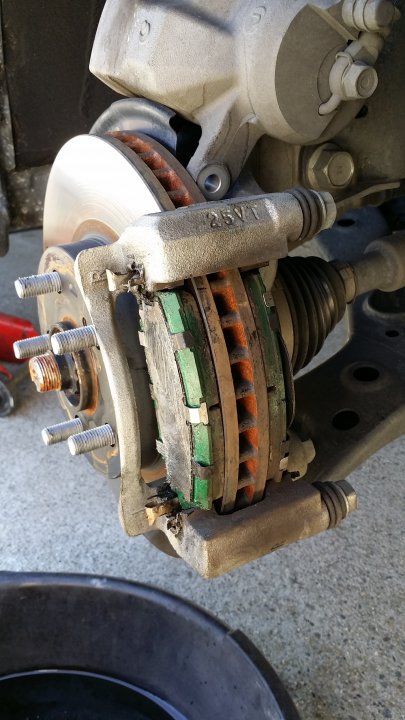

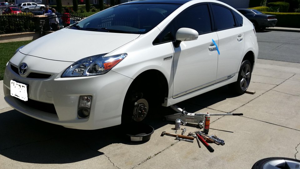

    priusbrake2.JPG priusbrake1.JPG It was time to rotate the tires so I thought I would do a lube job while the wheels are out. My 2010 is at 55k miles so pads still look good. Just want to share with everyone how I did mine and final result.
    The difference was that I did not disconnect the battery. I am a firm believer in the idea that if I don't open the driver door at ANYTIME after opening any of the 4 calipers, I would be okay. I basically cleaned all the parts with brake cleaner, lubed between the shims, back of last shims, between all the clips and caliper brackets, and between the clips and ends of pads. I did not have to compress the caliper pistons back in.
    Overall result is wonderful. No codes, and braking "feels" smoother. Here are couple of pics :)

    lol the blue tape by the driver door...
    sprtent likes this.

    Similar to the blue tape?
    When Apollo 13 was limping back from the moon, an aborted mission following an explosion that almost killed them all, well at least according to the Hollywood version, one guy was in the main unit, while the other two were in the lunar lander, doing some last minute stuff before they would get back into the main unit, and disconnect the lunar lander.
    When they floated back into the main unit one of them noticed a slip of paper taped over a switch, with the word "NO" on it. He asked the main unit guy: what's with this paper? And the explanation: if I pushed this switch it would disconnect the lunar lander, with you guys in it.
    Seems about on par.
    sprtent likes this.
