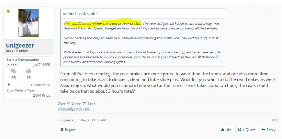

    Nope. You didn't specify front or back.
    "To take off the two calliper mounting bolts, pull the pads out, lube the caliper pins, clean/relube the pad faying surfaces, put everything back togetether, takes about an hour."
    It might be prudent for anyone preferring to have this service performed at a Toyota dealer or independent, to ask them specifically how much they would charge to inspect, clean and lube the caliper pins, effectively bypassing any mention of any other brake service.
