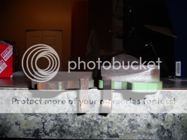

    might be of interest.
    short version:
    here is a brake pad with 108,000 miles on it from our prius (left) compared to a new brake pad (right).

    Are you estimating that at about 50% wear? A little hard to tell from the pick with the color difference and such. a light background would be better too.

    about 50% of the usable pad material is worn off. really not bad, huh? i expected them to look worse than that, considering the only brake work we've done is clean/adjust. but any savings on frequency of replacement are negated by the list price of OEM pads. they're not cheap, even with the deal we got.
    we also turned the rotors, there was a little minor rust tracking. DH just took it on a test drive and commented on how nice the brakes feel. so at least we have that.

    That's pretty good life.
    Edmunds' InsideLine had a 04 Prius with ~85k and they had to replace the pads. One of the editors did it themselves and their picture of the pad showed it was worn to the indicator.

    I checked the pads on the front brakes at about 120k miles and found 2 mm wear.

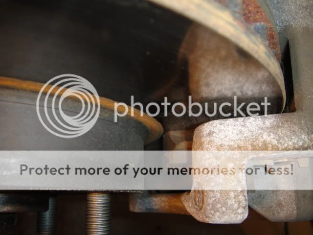

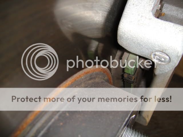

    Why does the new pad looks so much thicker than mine? Re: brake pad check: 108,000 miles
    I don't use the brake much at all but at 15K the pad looked not much thicker than the 108K one in the above picture, definitely much thinner than new:
    In fact since I first looked at 5K it wasn't nearly as thick as the new one:
    Weird.
