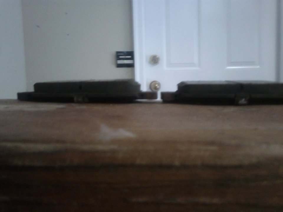

    2. Rear pads had abnormal wear pattern with the wear surface not parallel to the backing plate.

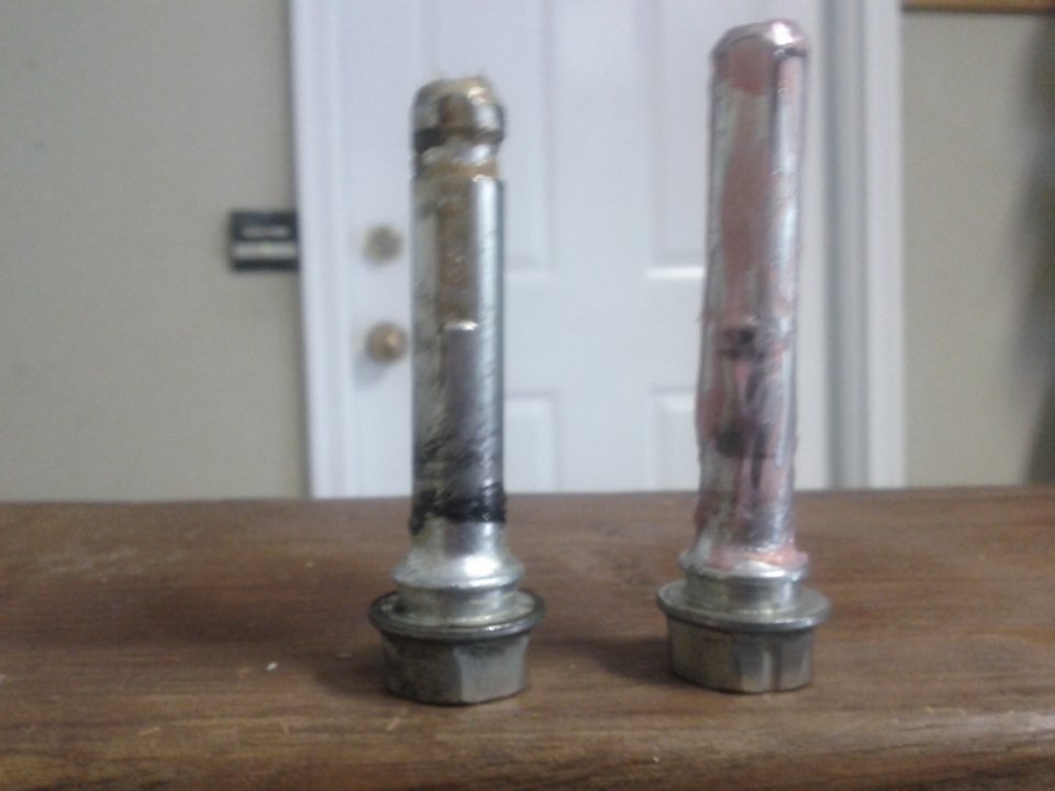

    3. 3 of the 4 front slider pins were hard to move and only had grease at the deeper end, and quite dry on the rubber seal end.

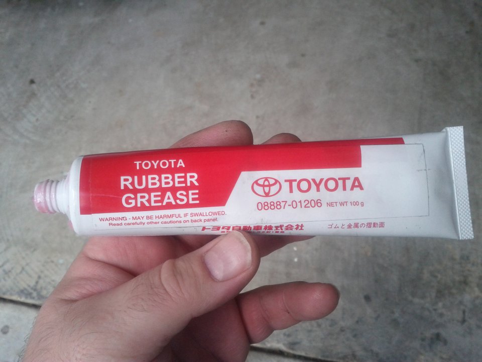

    4. The factory slider pin grease is yellowish, heavy and clearly different from the rubber/glycol grease Toyota specifies in the factory manual (pink and soft).
    5. The front lower pins had no rubber bushing in the grove (omission?), unlike other toyota cars.

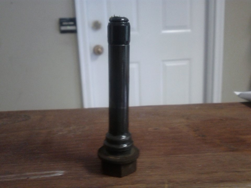

    6. The rear pins had different construction with black coating (moly?) . Smallish amounts of grease, but not stuck.

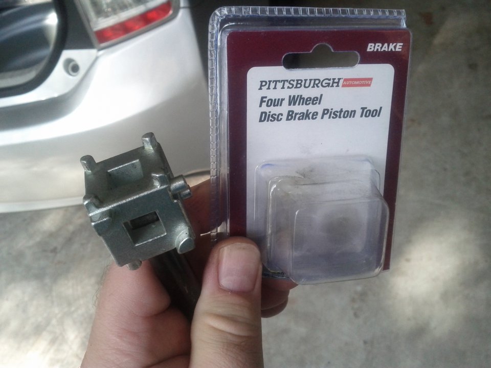

    7. One needs the brake caliper tool to put the rear caliper back even without replacing pads.

    Uneven rear pads (I know, the picture sucks):
    Front pins. Right: upper one cleaned and covered with rubber grease. Left: lower one with factory grease.
    Brake tool. $5.99 at HF (was $4.99 just a week ago):
    Official Toyota grease for slide pin:

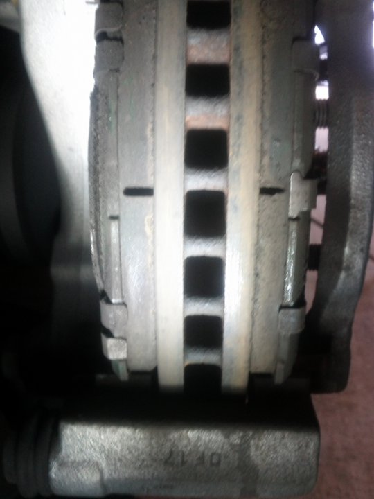

    Front pads in situ (hard to see a difference):
    One of the rear pins:
