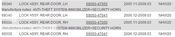

    Now I am ready to take on the challenge of replacing the rear driver side door lock assembly. I am browsing a Toyota part store online, but I am not sure which part I need for the read driver side door. This is what I found:
    Which part do you recommend and do I need the assembly with the anti-theft system? My Prius has an alarm system, but when I purchased the front door assembly there was no option for an anti-theft system.
