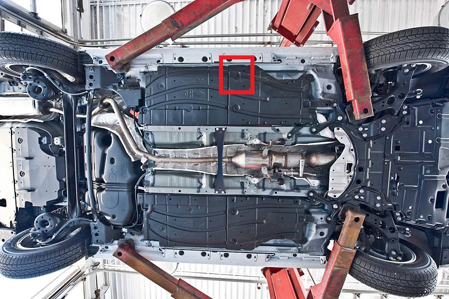

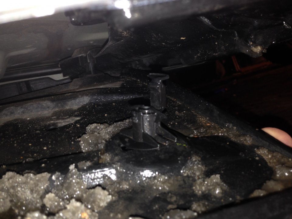

    My undercarriage plastic cover has taken a toll due to our recent snow storm, and now I left with a broken clip (pic below) the clip seems to be removable by twisting it off . But now that the clip is broken the panels are flapping all over the place at 60 mph and its driving me crazy, and the bolt that holds the clip unfortunately has bended also.
    The clip is located here on the driver it seems to hold one side of the 2 panels together
    Anyone know if the clip's part number? Im having trouble finding it online.
