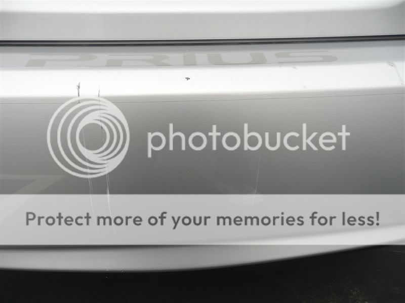

    We're about to buy a 2010 iii with scratches on the rear bumper. I want it look new, please advise with best practices to repair or replace... and approximate costs to do so, thanks!

    Sorry to see such a bad set of scratches. It's nearly impossible to make an invisible repair for something that bad. Unless it's an illusion, I think I see 4 other marks or guffs in that bumper. It looks like a replacement might be necessary.
    BTW, I had a small ding the size of a dime in my rear bumper and tried to fix it with OEM spray paint. You can still see it, but I'll live with it.

    Maybe that was your shoe...if the 2 long scratches are the only damage, maybe it can be fixed. But take a close look at them sideways to be sure there isn't some (even slight) indentation in the bumper from the scratch. If so, a repair might still be noticeable. Members have suggested it's possible to get it repaired like new, but is there a body shop in Irvine that can do this? For $650+ you might be getting close to a new bumper anyway.
    Someone else would have to answer if you can do it yourself. Unless you have access to a body shop painting booth, I'd leave it to the pros.

    This seems to be in the category "If you have to ask then the answer is no." A body shop can do the job. How cheap? Ask. I doubt it can be made "like new" in the driveway with amateur products & talent.
    How much are the scratches worth? After these are fixed what's going to be done with the next one?
    For some reason the rear bumper picks up vertical scratches. Due to the location of my scratch/gouge it can't be from loading cargo.
    The OP may be able to work out the one on the right through the shoe reflection. The 2 big ones may have to be sanded & filled. I suspect something was dragged up the bumper while loading.
