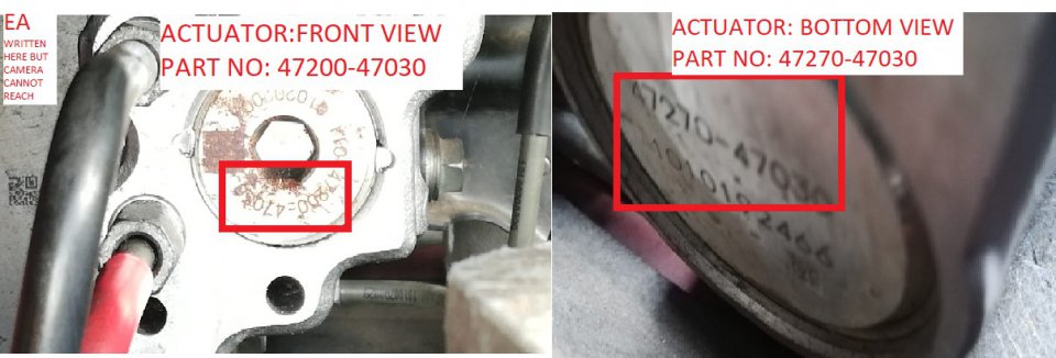

    Hello all
    I am having error code c1391 with my 2010 prius 17" wheels. i am looking for second hand parts to buy since local toyota dealer quoted $3625 for "pump assy brake booster" and $1875 for "brake master cylinder" and $400 for labor.
    However there seems to be a lot of confusion regarding the part number.
    i am looking to buy both the actuator(master brake cylinder) first then if error persists the accumulator(pump assy brake booster).
    When examinig the actuator in the engine bay i noticed there are 2 different part numbers: (see attached pic)
    1) front of actuator: 47200-47030 with letters EA marked to the right.
    2) bottom of actuator: 47270-47030
    I read in one post of Chapman that one if them is part number and the other mark number.
    So my questions are :
    1) can you please confirm which code (front or bottom) you used as part number please for actuator?
    2) will a 2016 model actuator fit in my 2010 car since i understand most 2009-2015 have these issues.?(2010=zvw30 2016=zvw50)
    3) also if i use a different part number for the accumulator will it work? my understanding is that the ECU is only in the actuator part and not accumulator.
    Thanks to anyone who can help with this please.

    I confirmed the part numbers and since mine is a japanese model the part numbers are:
    4705047130 for actuator : $ 2700 on megazip
    4705047060 for accumulator : $ 900 on megazip
    Pretty expensive new parts and so far no second hand available in my region since 17inch wheels are not that common.
    Anyways still looking for the parts and hopefully i will get a second hand part soon.

    The only accurate way to get the part number is from a Vin look up using a dealer parts department. Some online sources like McGeorge Toyota will also verify the proper part numbers based on your Vin if you ask. There is actually no part number on the master cylinder that is useful. There is a housing number which is common among multiple different configurations and part numbers.
    I assume you are over 150 thousand miles and or the date of delivery is over 10 years. Under 150 and 10 years qualifies for a free replacement assuming the system is providing the proper codes.

    The part had been recalled several years ago, but coverage has expired under the one 150 10 year thing. it is doubtful there will be new coverage.
    Some have used used parts, but that's tricky primarily because you need to know the Vin of the donor vehicle and have it cross referenced to make sure that you have the proper part number.
    A Prius master cylinder is expensive because it is part of the brake by wire system. It has a brake ecu in it and it is the ABS and traction control controller. It also has interfaces to the brake pedal and the regen system. A separate part is the brake pump assembly. It provides hydraulic pressure for use by the brake by wire system.
    Finally installation of the system requires the Toyota scanner in most cases because of special brake flushing and calibration requirements. If you have an independent mechanic doing this, they must also know about these special scanner procedures.

    You are having a problem because someone is misunderstanding how these parts are assigned part numbers. It is not on the part!
