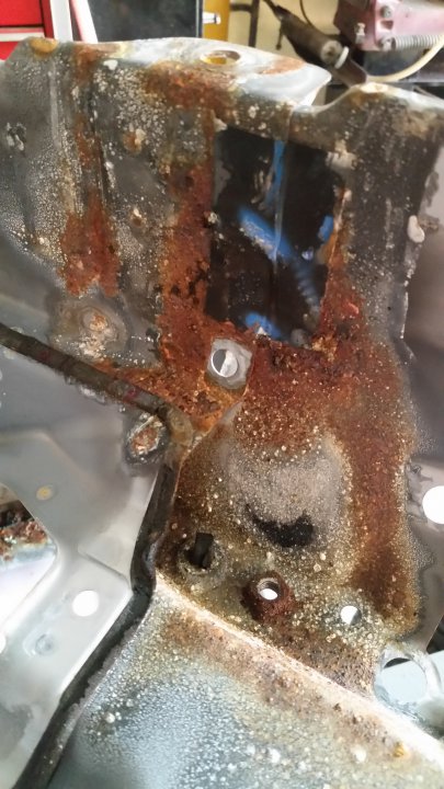

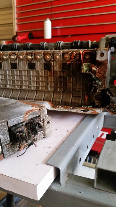

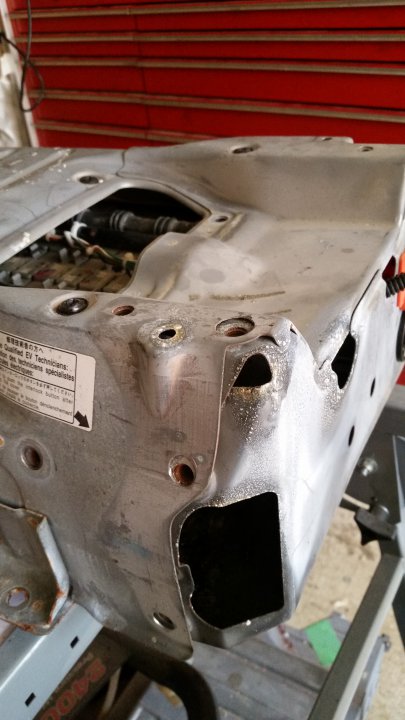

    I recently bought an 01 model that I knew had bad batteries. It has 246,000 miles. The codes that were in it when I looked at it said that the hybrid battery was bad. It had a bad aux. battery as well. There were a couple of C codes that I couldn't get much info on. Thanks to Prius Chat and those that have contributed, I already had a battery pack for it reconditioned with gen 2 modules.
    NOTE: When I pulled the traction battery out, it had been so hot that it burnt the wiring harnes up that plugs into the ECU and melted a lot of the plastic that covers the terminals and wiring harness. It even burnt the sheet metal around the ECU end and burnt a hole in the carpet that covers the battery pack. This car could have burnt to the ground. I'll try to post the pics here.

    The car I started this thread about is the 2nd 01 model I've bought, since my wife liked my car better than her 06 model (why, I'll never know!). I bought the 1st one with 122,000 miles on it and bad batteries since I had already rebuilt my wife's 06 battery pack. The last module, #38, had a hole burned in it and the ring terminal on the sensing wire that should have been on there was completely gone. It also melted the casing of mod # 37, almost completely through. I pitched those 2 immediately and 2 more after I started the reconditioning since they didn't want to cooperate. Since I couldn't get the capacities close to 6000 mAh I bought a used pack out of a front-end wrecked car. That pack only had about 4500 miles on it as verified by the invoice from the dealer. The dealer had to put new batteries and tires on it to sell it and the guy that bought it had it less than 6 months when it was wrecked. So I bought the batteries (HV and aux), tires, and a marker lamp lens on the front bumper since that was exactly what my car needed. The 12V battery only had 1.36V when I brought it home. I never expected it to come back to life but I figured what the heck, it can't hurt to try it. I put it on the charger and for 4 or 5 hours it didn't do anything. I was about to pull the plug on it when I got sidetracked for about 3 more hours. When I came back it was charging! I left it charging overnight and the amp guage was back to 0 the next morning. It was alive!! I definitely believe those are good batteries (GS YUASA).

    That's interesting. So you've bought two Gen 1s with battery projects and in both cases there were signs of smoke, not just old tired modules going gently into that good night?
    But in the first one, the damage you found was at the individual terminal connection to module 38. Just to be clear, when you say 38, you mean the one farthest from the ECU end?
    While any battery fire is a concern, I think that one doesn't quite fit in the list I made above, which is all PriusChat threads that I know of involving fire at the sense harness connector into the ECU. The ECU connector failure seems to be a pattern we might want to take an interest in, having seen the first one (unless I've missed others) just two years ago, and three more since then ... and I'm not sure I have a good theory how it starts. I completely understand how, once it starts, it goes big. But what starts it, I'd like to understand better.
    The issue at terminal 38 seems probably simpler. At least I have an idea how those might start. The terminals can grow mushroomy corrosion crystal structures, and eventually one might touch the metal case. By itself, that probably has no effect besides setting a P3009 code. But if there's any chance the previous owner had a P3009 and ignored it long enough, eventually some other stalagmite in the battery becomes the second one to touch the case, and right then things get dramatic.
