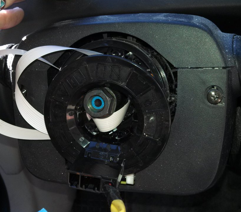

    Can I drive the car ('04 Prius) with the airbag and clockspring removed?
    (I removed the clockspring because it sounded like fun, but I haven't yet
    decided where I'm going to obtain the replacement or repair. Meanwhile,
    I need to use the car daily, including a 400-mile freeway drive in a few days.)
    I know the airbag and horn and steering-wheel buttons won't work, and I
    expect to see an airbag warning light and maybe an airbag trouble code.
    Apart from that, can I drive the car without (a) damaging it, and (b) risking
    a breakdown?

    Yes, you will see the airbag warning light appear which means the skid control ECU has logged a DTC. You can drive the car in that condition.

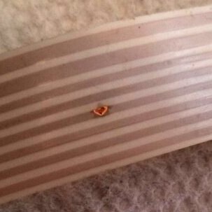

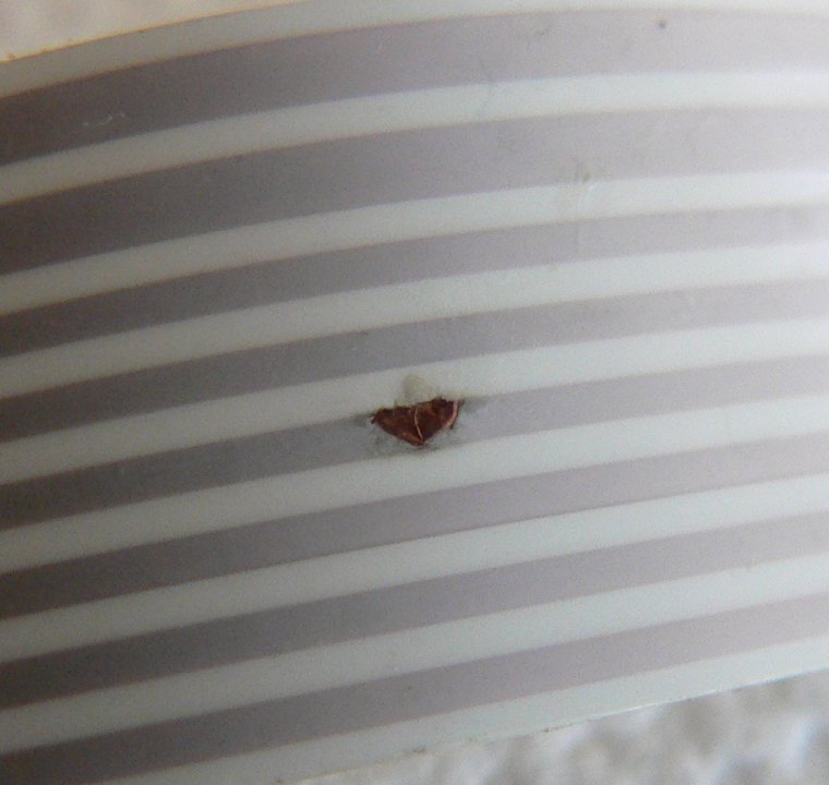

    The defect was apparent once I opened the clockspring and inspected the cables closely. Not sure how I'm going to attempt to fix it. But at least I know not to expect gradual deterioration of the other wire traces.

    Not a permanent fix but one that works. Scrape off some of the insulation along the conductor track. Then solder across the break, covering the repair with a short length of tape on either side using a tape that does not bleed it's adhesive.

    Thanks, John. I considered solder, but melting a hole in the plastic ribbon might be unavoidable consequence. And I'm too miserly to buy conductive paint. I've flattened out the existing copper, then covered it with a dab of Liquid Paper. (I'm afraid of what acetone-based nail polish would do to the plastic ribbon.)
    Anyhow, taking things apart and spotting the defect was 90% of the fun. Actually repairing or replacing the thing would be only 10% additional fun.

    I put the soldering iron to it, and as I suspected, burned a hole in the plastic ribbon. I've ordered a new replacement part on Ebay for $57. I can't bring myself to pay the dealer's parts and labor charges.
