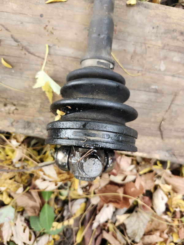

    Basically, I have a two Prius', one is a parts car that is wrecked in my yard and the other is what I drive (has over 300K miles). Recently noticed while doing other repairs that my PASSENGER-SIDE CV BOOT was torn and had a small leak. No clicking-sounds or more noticeable signs of failure yet.
    However, I also recently removed my DRIVER-SIDE axle off of my parts-Prius. Can I use either boot and replace the torn boot on the other Prius OR should I remove the entire passenger-side axle off of the parts-Prius and replace it instead of the boot.
    I read in another thread that for some reason, passenger-side boots tend to go and driver's side don't on Gen 2 Prius.
    Also thinking about just having a shop replace the CV boot since it'll be messy/greasy, but not sure they do that anymore as I've read they tend to just replace the entire axle nowadays. So my options are...
    A. Replace boot with used boot
    B. Replace axle with used axle
    C. Forget about it and let mechanic worry about it
    Thoughts?
    CV BOOT outer-side that I'll actually need

    If this was me; I'd replace the whole axle from the parts car. Isn't that what it's for?? You can buy a $10 boot kit and repair the old one. Quick swap, less down time. If you just replace the boot, the axle needs to come out anyways. There are expensive, quick boot kits - but in my experiences they don't last very long.

    yeah I'll probably do that but since I already have the drivers' side axle off thought I could use the boots before i toss it.
    why can't I just slip the parts-cvboot over the working prius's axle?

    No, replacing either inner or outer boot requires removing the axle and the joint. The outer joint needs some tools (a vice, hammer, drift, some finesse) to get off. Or take the inner joint completely off and just slide the new outer boot down the shaft. Then put the inner back on.
    You'll also need whatever tool the boot clamps need to fit them. Yes, the job is very messy. The split "quick boots" always leak after a bit.
    Yes, almost no one replaces boots these days. Chinese axles are cheap enough and (mostly) good enough that unit replacement is the common repair. It was a different story when the only new axle was the dealer at $700+ each.

    My vote, replace it with your complete parts car axle.
    But, do inspect that used axle for "damage" and re-grease it fully.
    If no budget, buy a new complete assembly.
    FWIW
    Yes, boot only replacement is rare these days.
    I understand boot only can be a difficult job with specialty tools involved.
    Also, I would be hesitant to use the "split" boot repair kits, although I understand in theory, the axle does not need to be removed to install a spilt boot.
    Lastly, there are kits that use an expander to slide over the axle without axle disassembly, yet I have no experience in their long term sealing properties.

    yeah. I feel like that's what I'll do. seems such a waste to throwaway a perfectly good (well 300K miles on it) CV boot though. Of course having a wrecked Prius in my backyard is pretty explanatory of my mindset.
    this youtuber says to replace the axle but is doing the video for those who want to replace the boot...seems very laborious vs. replacing the axle.
