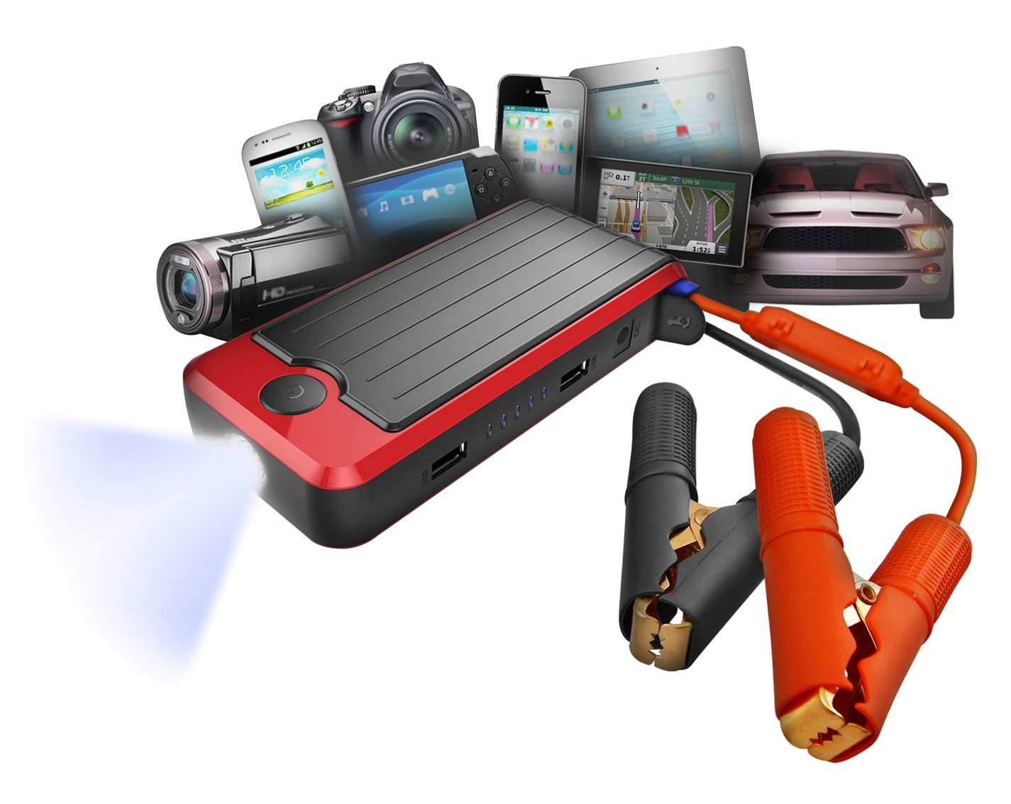

    Thanks for asking this question, I've been wondering the same thing. Now I need to decide if it's worth $100 to buy one of those small portable charges that also will jump-start a vehicle.

    Jim, I looked at that when you mentioned it before, but nixed it for 2 reasons; it lacks a USB port and it's quite large compared to the PowerAll I'm considering. However, I just did a little more research and found the XP-500 with a USB port for only $8 more, but it's just as large. I've wanted a portable power pack that would fit on my camera bag, but didn't want to spend the money just to charge my phone. Then I found some can also jump-start a car and there's so much discussion about the battery here, that I figured I'd better consider it again. Maybe I'm being overly cautious, but our upcoming trip will be the first time (I think) we'll be quite far from road services at times, especially in Wyoming, Montana and North Dakota, where I wouldn't want to be stranded waiting on road service from either Toyota or even AAA. I once left a portable cooler plugged in overnight and our departure in the morning was delayed over 2 hours because we had to wait on AAA. Yes, it was free, but then we had to make up the time and than meant cutting out a stop or 2.
    Anyway, I don't really like the USB and power outlet being in the console and having to dig through stuff to get at them, but I don't know yet how much I'll even use them. The Garmin will be plugged into the outlet under the dash/console and my wife will probably need to charge her phone while we're traveling. I may buy this power outlet extender to better use the power outlet in the console. Then I could add the cheaper XP400 just for emergency starts and throw it in the back. FWIW, I have backup batteries for my camera, but I like to use an AC Inverter to charge a spent battery while we're traveling and not wait until we get to our motel for the night. I don't know if the Prius is any different than the van was as far as doing that is concerned. Given all the expensive electronics, I don't want to risk damaging things.
