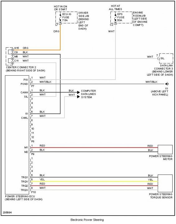

    The power steering should work in ignition on mode (two pushes of the start button) as it is electric, not engine driven. The diagram shows the supply to it is there in "on" or "start".

    Must admit I have not tried this, but looking at the circuit again it may need some input via the data lines from another ECU. See below.

    Yeah, who knows what it takes to get the pwr strg motor running but, JC could go to IG ON on his good 06 or 08 and see what that one does for pwr strg.
