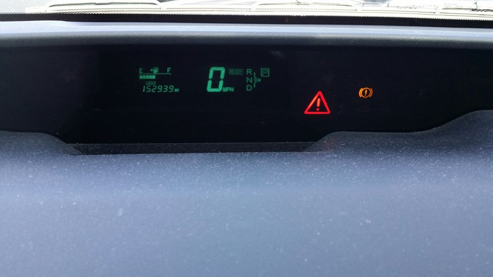

    The other warning light looks like a steering wheel with line running through the middle.
    I have a regular obdII that I hooked on, erased all the codes and the car was able to start again. I'm able to start and shut down as many times as I want, as long as the red triangle has not appeared. Once the triangle appears, it won't start again.

    Please take a sharp photo of that and post.

    The red triangle comes back pretty quick. Might go into limp mode? Here's the 2 warning lights uploaded.

    The amber warning light has to do with the brake system and is not related to the steering system. That is not surprising since we know your car has logged a DTC associated with the brake system.

    The red triangle is also known as the master warning triangle light. The point of that light is to call your attention to the fact that the car has a problem. Then you are supposed to look around at the other warning lights and messages that may appear on the MFD screen, to try to figure out exactly what the issue is.
    So at the moment, since you see only the red triangle and the brake warning light, the diagnostic systems are aware only of an issue with the brake system.
    Later on, you'll probably see the hybrid vehicle warning icon appear on the MFD screen, which will show you that you have a problem with the transaxle.
