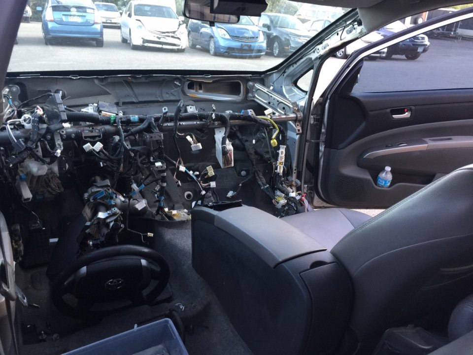

    Just got my 2006 up and running. Only light is the tpms. I replaced sensors but still on. Went out to drive it and started up. Had to run back in the house for about a minute then returned. All dash lights were illuminated, abs, traction, check engine, triangle etc. car backed up but would not go into drive. Put in N and coasted back to park. When push start w/o brake, the MFD comes on and looks normal. Then when pushed with brake, briefly says “problem” then shows car in red. Will shift into N but that’s all. Update: unplugged all batteries and sat all night. Then opened up the dash and unplugged/replugged connectors and all is working, except gas gauge is blinking. Any ideas? Here is a before pic and after. I hate to leave the house and get stranded. Was lucky to be home

    FYI came home and all was working fine. so I put it back together. I left off this pigtail that was "spliced" in between the harness and the MFD. Not sure what it's for but everything still seems to be working. Image of the spliced in wiring harness (with the little circuit board) is attached
