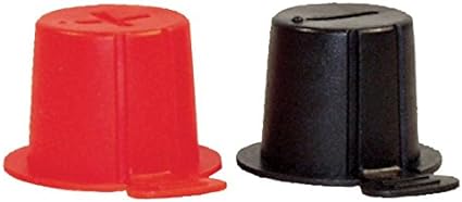

    At the risk of sounding condescending (no offense intended) are the battery terminals uncovered on the new battery? Batteries often are shipped with thin plastic caps on one or both terminals and (especially black or clear ones) can easily be missed during installation which prevents a 12v connection:

  5. dig4dirt
    dig4dirt MoonGlow
    Apr 6, 2012
    1,153
    741
    Lancaster Co PA
    DAYYUM! you never know!
    Actually hope that is it, makes sense!
    Or just a defective 12v
  6. Mendel Leisk
    61,397
    42,250
    I don't think the clamps would go on, with the plastic caps still in place.
